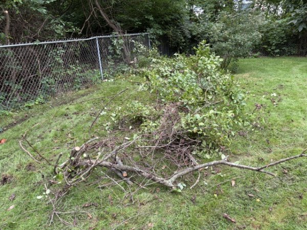

    Had a close call with the 026 running lean last weekend. I was cutting up some small saplings against our fence and noticed it seemed to be reving out a bit. Also, the RPMs would hang after letting off the throttle. Then, it started to bog, shut down….and would only burble a bit upon trying to restart it. Ugh!
    I finished the cutting with a Kobalt battery saw that came with a tool score a few months back. Thankfully, that worked really well.
    After the cutting was done and the brush was loaded, I attempted to start the 026. It fired up…but rev’d a bit. I shut it down. The next day, I pulled the muffler and inspected the piston and cylinder. I pulled the engine over so I could see the top of the piston, cylinder and piston skirt. Everything looked just about perfect. Phew!
    So I think after this long winded explanation, I’m going to need some crank seals. Not an expensive job, but seems that getting the seals out on the 026 is a challenge due to their small size. I welcome any advice.
    But before I start firing off the ol’ parts cannon, I’m going to do a compression test. And hopefully a leak down test with a brake bleeder and gauge that I have.
    Glad this happened in my back yard and not out on a scrounge! Coulda been a lot worse.
