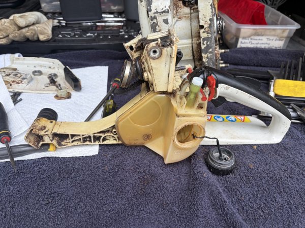

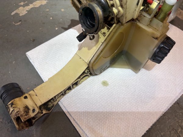

    I ended up pulling the handle off so I could get to the tank and have a closer look. This is the furtherest I’ve taken apart a saw. They’re fairly straight forward…and are really compact, so you have to be creative with removing some parts. But I’m sure most of you have been there, done that!
    Turns out, the tank has a small leak.
    Now, I could slather some fuel safe epoxy on this and call it day. But not sure of the longevity of that, given it’s on a seam. Any thoughts on a replacement?
    Yes, I’m working on the tailgate of my truck. Makes a pretty decent workbench for a project like this.
  3. WeldrDave
    10,205
    56,292
    Working on a towel, VERY smart! :yes: I always keep a "white" towel on my gun work bench. Those little screws and springs show up easy on a white towel. Also a suggestion if I may, get you a magnetic tray!! ;) That will keep those screws (just where you want them) and can find them.... :binoculars:

    If it's a pin hole, I might try just cauterizing it with the tip of a hot soldering iron. Then there is plastic welding, with something like trimmer line as filler. Next JB Weld, they might have a gas tank repair formula? Aftermarket tank probably has flippy cap...yuck. You are in a good place to renew any questionable rubber stuff on the old girl.

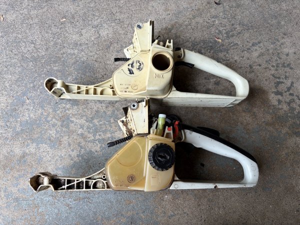

    I ended up going to the guy on Marketplace. He’s not far from where I live and ironically works for the town I live in. He’s a really good guy! He spent a lot of time explaining the differences in the saw styles, how the outsides looks different, but innards are the same. He also was able to look at the part numbers on the handles/tanks he had vs mine and show which were newer. He tested my impulse line and the carb boot. He also showed me how the style of 026 I have has the choke built into the filter vs the carb. Long story short, knew his stuff and was willing to help out with some advice. He even offered for me to bring my saw back if I ran into any issues getting it together or getting it dialed in after getting it together.
    Here’s what I picked up; unit up top is what I bought from him, one I had is below.
    I paid $60. I thought that was fair. However, given the advice I got from him, totally worth it. Definitely someone I’ll keep in touch with.
