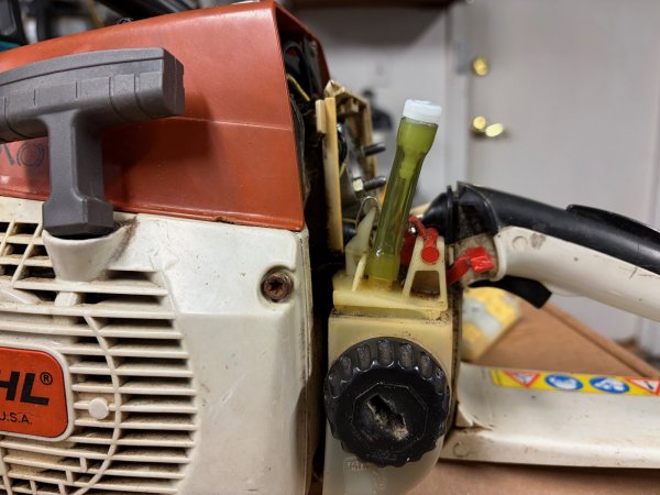

    Here’s what I cobbled together with one of the three vents (3 pack) I got from Amazon. they came with a much smaller hose that would not have fit over the tank. I ordered the OEM Echo one to see if that would fit on the hose better. I’ll see how this works for now. This was some spare snowmobile fuel line I had up north. 1/4” maybe? I’m a little rusty with sled line sizing. IMG_0058.jpeg

    I suggest jamming a small hose into the bore of the tank spigot, not the outside.
    It’s a bit unconventional. ETA what you show will probably work as long as you don’t bottom out the vent cap on the hose.

    Thanks! I’ll give that a go! That one I bought came with a smaller hose that I should be able to install and get into the tank. I did put this one to the test…turned the saw upside down and sideways..no leaks.
    I did have another random issue today. I haven’t run the saw in two weeks. Started up today, gave it a few revs and it seemed to just kinda bog after 1/2 or 3/4 throttle. I opened the gas cap, no difference, pulled the tank vent…no change. Gave the H screw a 1/8th of a turn out…no change. May be time to pull the carb and inspect.

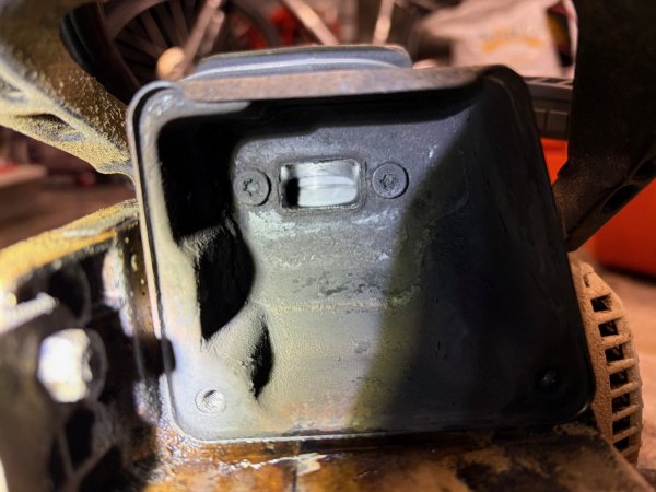

    Some have a baffle box, and some are an empty can, depending on age. There is plenty that can be done just modifying the exit area of the cover with a drill.

    Here’s what mind looked like when I pulled the muffler. Basically, the front came off and this is what was behind it:

    Look at the cover where the spark screen is. Some have 3 little holes. You can carve out the metal in between and end up with more of a slot. The bigger the better for flow. Or, as you say add another outlet.

    Yeah, tough to say. All oem fuel and impulse lines are needed. That red lever style tank vent can be modified in a similar fashion to what you did. I sometimes keep the oem vent if it’s working. The tower vent (smaller plastic nipple) works well enough with the flapper valve installed.
    If you think you have a tank leak, go through it. It’s likely at a seam or the cap area. The cap itself could be a leaker, too. One can usually find the leak without separating the tank from the case.
    OEM fuel line (2 styles… if po owner updated then verify fit into tank, hole may be off a the grommet may not fit right), OEM impulse, tank vent as pictured but verify that it leaks air and not liquid, go through the carb and replace anything that’s stiff. I would personally kit it and start fresh. No more starting fluid… just a shot of mix but I don’t even do that anymore.
