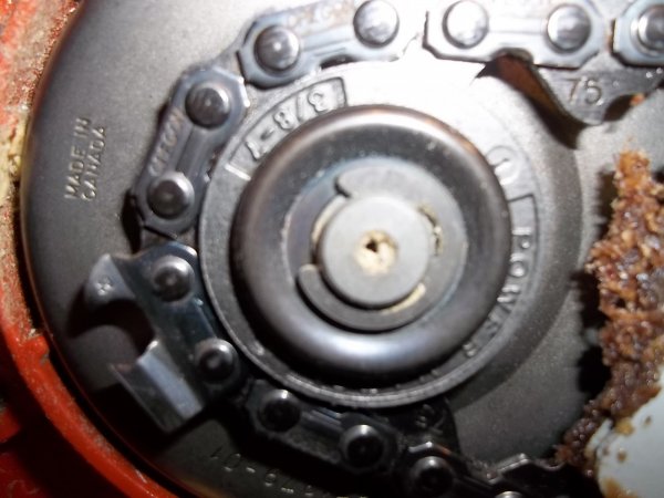

    Or post up pictures of the i.d. marks on the original bar and chains. Lots of folks here will be able to tell you if they are a apples v. oranges.

    all the numbers you need for a replacement chain are stamped into the bar although deciphering the sequence is sometimes a bit challenging . a little searching of the electronics will resolve that though.

  12. Andyshine77
    Andyshine77
    Feb 8, 2014
    383
    1,955
    Cincinnati, OH
    The 73 on the drive link means it's .058" gauge chain, which matches that bar.
    3/8 is the chain pitch.
    .058" is the gauge aka the thickness of the drive link
    119 is the number of drive links on the chain, this determines the length of the chain.

    Yes, to .063 and the number on the drivers is 75 .
