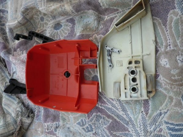

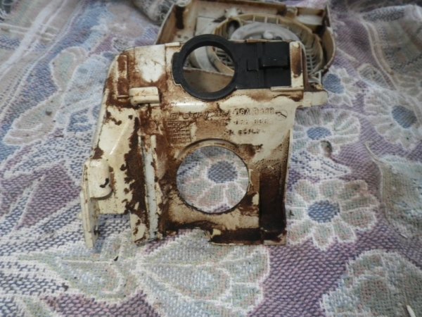

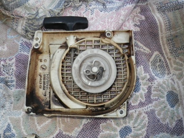

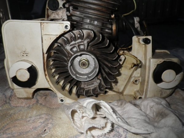

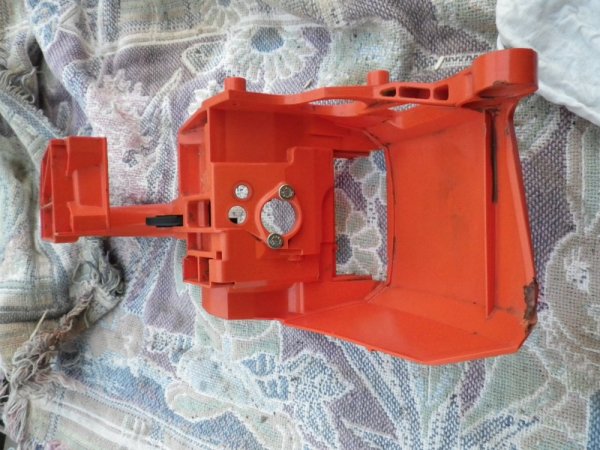

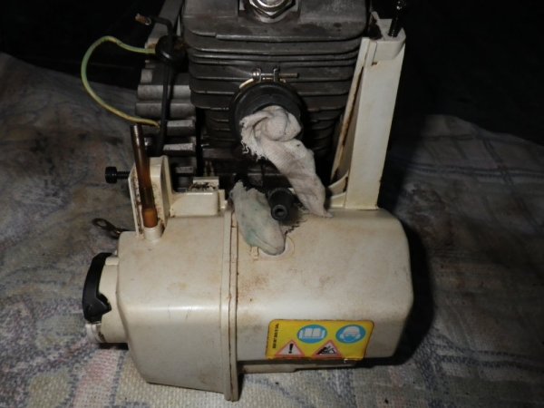

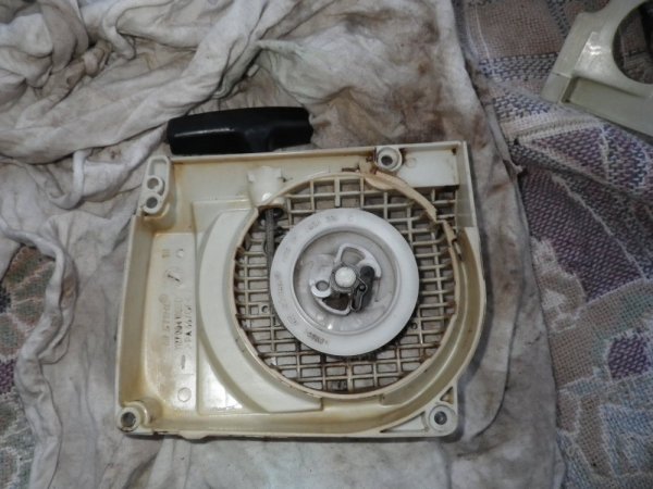

    Tried to get the parts I needed today but the dealership didn't have them and they won't be in until Wednesday so I did some cleaning and detailed every bit of the saw which should make the reassembly go much easier. Here are a few before and after pictures.
    Before:

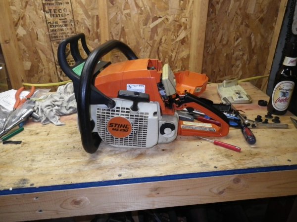

    Parts came in today so after I got home I went out to my balmy 35 degree garage and took 1.5 hours to put this thing back together. There were a couple of times I had to think hard about how it came apart but all in all it went back together well. I did notice while I was rolling it around it seemed like the tank vent may have been weeping a bit but it stopped so I am just going to keep an eye on it for a bit. Anyhow once I got it back together it fired right up and was running great :thumbs:. It doesn't bog out at all now when you blip the throttle, revs right up and idles way better also. I was cold and hungry at that point so it's sitting back on the bench but I can't wait to really run it to see how it does. I also want to mod the muffler so that's next after a few tanks of fuel.
    Final results of tonight.

    Looks great Cert! Nice work! :)
