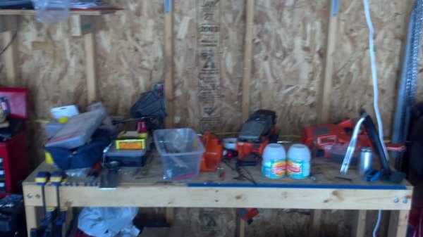

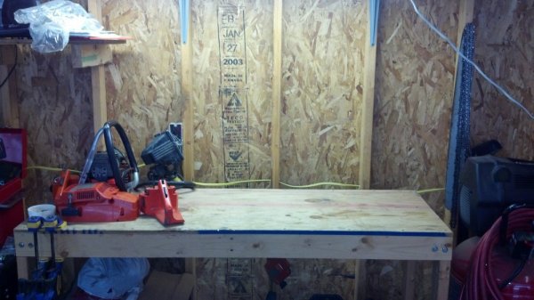

    Had to get the bench cleared off a bit before real work could begin.
    Before
    After

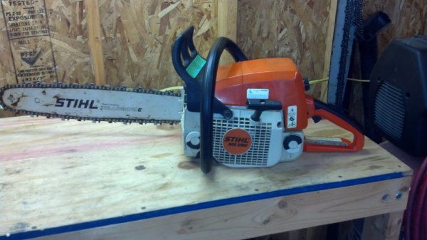

    Finally got it on the bench.

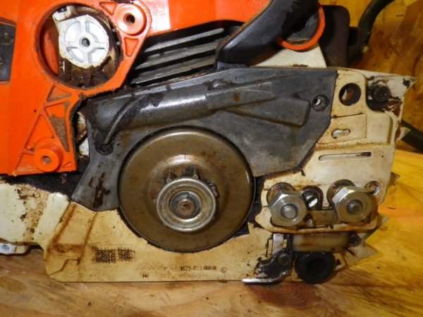

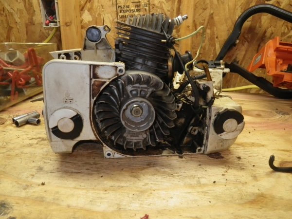

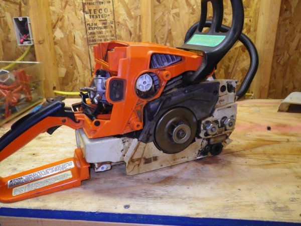

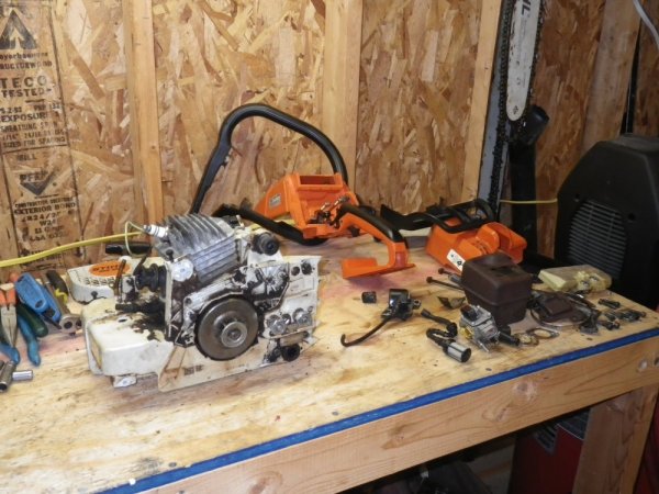

    Now here is where the work begins. First impressions are that compared to the few Huskys I have torn down this thing is a royal pain in the butt. Why the inboard clutch on this saw? I guess this is the first saw I have owned that has one like that? Here are some photos of the tear down and my pile of parts

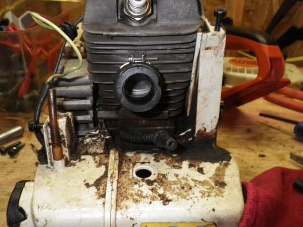

    I am pretty sure this is a bit of a problem! I'm not sure if I did this taking it apart or if it was the problem from the beginging. I know I saw fuel leaking before the tear down but the fuel line where it goes in the tank was also really loose. The filter looked good and the tank seems pretty clean on the inside.
    Also the carb seems really clean however I forgot to snap a picture but the idle adjustment screw seem to have the screwdriver slot all messed up. I need to go back outside and look at that again.

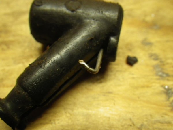

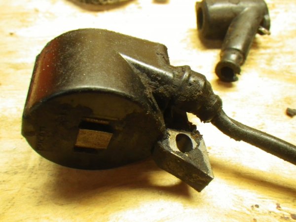

    I found the plug wire looked like it was split and had tape on it further investigation revealed this the plug boot is split and there is a metal wire coming off the boot and it hooks through the wire....... Is this ok or does it need replaced?
    Chvymn99 likes this.

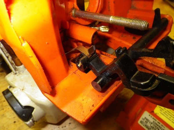

    11,912
    In The Hills

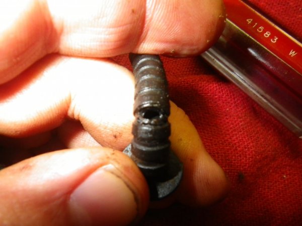

    And here is where I screwed up........ I though you could pop the wire out of the throttle linkage and broke it off. Apparently it isn't removable? Is there a way to fix this or do I have to buy a new throttle?

    Finally the piston look pretty good but it seems like there is a bit of carbon buildup on the exhaust side. I'm not sure it's carbon it more just feels rough on your finger .
  17. MasterMech
    9,648
    26,040
    Greenville County SC
    Thats the first time I've heard an inboard clutch being called a "pain in the butt". Lol. Usually hear that about an outboard. :rofl: :lol:
    New plug boot, reset the hook in the wire, and repair/replace the kill wire, you should be in business. The kill wire IS normally removable.
    Throw a fuel line in it of course. The carb looks clean on the outside, but it's inside that counts. I would correct the obvious issues first and see how it runs. That carb is easy enough to remove should you need to give it some more attention. Snap a pic of the messed up screw if you get a chance.

    I guess what I meant about the inboard was it was a pain to have to tear it down just to remove the plastics on the saw. The carb looked great on the inside also, although at this point I probably have the carb settings screwed up enough that it need retuned anyhow. I'm going to screw them in and start fresh. Maybe the kill wire is removable but the tab broke off trying to get it out I will give it another shot.

  20. MasterMech
    9,648
    26,040
    Removing the plastics is a pain because of how the handles are tied in to each other. A few more screws than most saws to get it down to the point of where you are. At least you don't have to pull the engine. I have had a couple customers ask me about doing a piston/rings on a 1127 series saw. It's seldom worth it ($$ wise) unless the saw is pristine or it's a DIY job.
