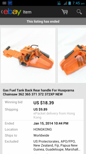

    Didnt they tell you to plug the vent and get the green venting cap? Or was that someone else? Heck after all these vents you could of bought you a new chiacom handle off ebay! I got a new one in stock I think I have $28 in.

    From what I could find the green vent won't work on this saw. I went looking for a cheap tank on Ebay and couldn't find one...... If you have leads on a $25 dollar tank with a vent in it let me know. I already have brand new AV mounts on this tank that could be removed.

    What saw again 272?. The chicom tanks come with AV mounts . At least stihl do.

    Sorry the 272 and 372 are different tank handle. All I saw is roached out ones on Ebay.
    Here is the handle I boug Screenshot_2014-02-20-07-45-31.png ht to prove I was not exadurating . Quality is pretty good on them too.

    I believe you on the 372XP tank but I have looked high and low for a 272 tank and have not been able to find one. I keep watching for a 272 parts saw but haven't seen one of them either. If anyone notices one let me know. Also if anyone has an idea what epoxy would hold up to fuel I would appreciate the input.
