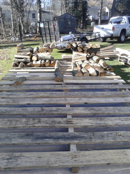

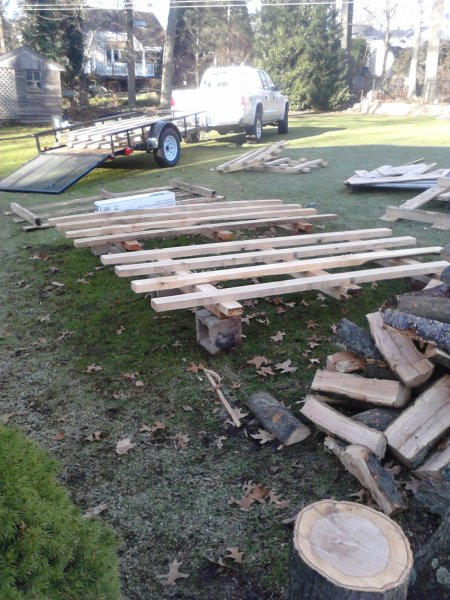

    Ok getting started, here I have solid oak, true 2x4 inch pallets that I get free from a brewery:pete: :cheers: on the other end of the city. I laying down the sub flooring to give the structure strength.
    Here I've laid down a vapor barrier of 6 mil poly, over that I laid down the floor pallets that I get for free as well from another factory, they measure 4 ft x 10 ft long with only 3 top cross boards that run the 10 ft length so I added pieces from other pallets to fill in the floor boards, you can probably see them over lapping. Anyway, this is what I will start stacking my wood and I will be extending the floor to 20 ft x 10 ft, right now it only 10 x 10 ft.

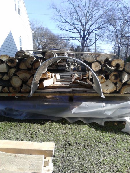

    Ok lets get started stackin, on the left the beginning and notice the tunnel for the heat, on the right is the intake port where I will place the space heater. Keep in mind this is all new to me and I'm creating, master minding and building as I go along, so thing are most likely bound to be changed and altered as I see best. Right now I have a pretty good idea of what and how I'm going to proceed, but the area that may have some changes is this heat port and tunnel. I do not want things to go wrong or melt the poly anywhere, but I've got some added protection ideas.
    Hope you enjoyed what pictures I have .:chef:

    You are probably better off with the propane heater. The forced air kerosene ones probably push a couple hundred feet of air a minute. In essence all you would be doing is blowing warm air past your stack on its way to heat the outside. You want the heat to stay there and do its work. If you raise the air temp by 100 degrees in your kiln you will effectively reduce the ambient RH to almost nothing. Get a fan inside the thing to keep the heat circulated and with minimal air leakage you will vent the moisture.

    I understand what you your saying about the use of the torpedo heater or space heater, but my kiln will be sealed up tight with 6 mil poly and shipping wrap. I'm thinking about installing one large or two mid size vents on the top side opposite the heater, ones that I can open and close.
    I'm still gonna play wit the torpedo heater at first in hopes that a 10 ft offset with the heat traveling into the stack via an 8 inch heavy aluminum pipe would reduce the massive heat blast, but we'll see, if not I'm gonna try something different wit the propane tank top heaters.
