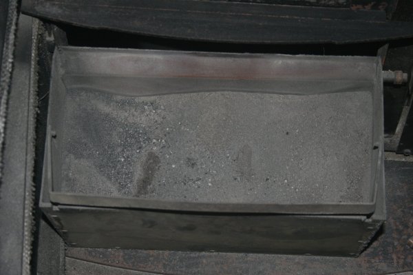

  13. jtakeman
    12,330
    55,579
    I've burned 50 bags in a month during the cold. And I don't buy clean pellets. I burn meh pellets cause I'ze cheap!! :D

    I would be embarrassed of a stove that dirty. :whistle:

  15. slvrblkk

  16. jtakeman
    12,330
    55,579
    Ize proud of da beast. She eats chit and spits out heat.
    She's burned Dog/cat kibble, acorns, grass, grains, coffee, cherry pits, olive pits and leaf' pellets. Should mention bunny poo too.
