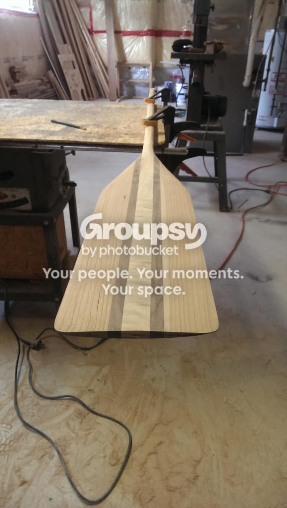

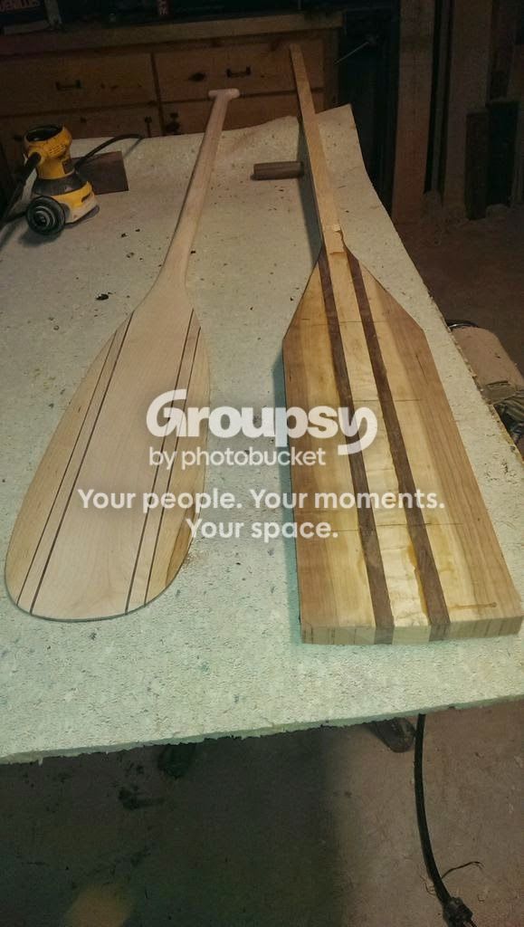

    Couple of paddles a friend and I are fabricating. The left one is his. It is maple with walnut strips and is almost finished shaping, then final sanding, staining and varnishing. Mine is on the right; cherry outsides, walnut strips and ash through the centre. It is not as far along as my friends; only the initial gluing and shape cutting has been done. It still needs to go on a diet. Note the walnut my friend turned for my handle under the shaft of my paddle.

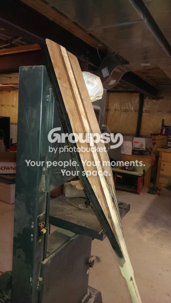

    Next step: Centre line & paint. Before painting the blade edge black, it was scribed with a device that scratches a line to denote the middle of the blade. A little hard to tell in this pic but the shaft has been router-ed from square to round. Eventually I will thin out the two sides to make the shaft oblong in shape.

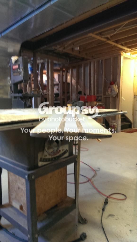

    The excess paint has been removed revealing a centre-line of black which will give me a guideline of where the mid point of the thickness of the blade is so that it can be evenly shaped. Also, the blade portion has been run through a thickness planer to take out the unevenness of the various wood strips.

    Very nice. What do you use to finish them? I have a set of oars that needs refinishing.

    Hey Jon, thanks. I bought a pair of paddles from a somewhat famous local guy here in Ontario; Ray Kettlewell. He told me what to use to refinish the paddles but alas, I didn't write it down and he sold his business last year. I'll email the guy that bought out his business. I'm going to need to know myself soon.

    How do you pare them down. Plane? Does the different wood species cause any issue with expansion or contraction of the wood? Lastly are the different species just edge glued or are there biscuits or dowels?
    The reason I am asking is that the oars I need to redo are separating at the individual pieces and I am probably looking at a rebuild.

    Jon, a portable electric planer set on 1/16" is used, then dialed down to 1/64" for finer tuning. After that a belt sander is used, then a palm sander.
    The wood is glued with biscuits, but my buddy says glue alone is just fine as it will break on the wood, not the joint.

    I'm thinking of painting the bottom 1/2" of the blade with epoxy and coating with silica sand; maybe with 4 coats. I was told it's better to push off rocks and such with the blade than the handle. Thanks for the compliment.

    Some more initial shaping with a portable planer, set at 1/16”. Fine tuning is done with the planer dialed down to 1/64". Works very fast.

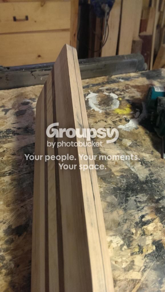

    Blade profile after planing:

    Blade profile after belt sanding. It needs to be thinned out just a bit more, then finish sanding.

    That looks great. Nice pictures. What is the difference between the rounded profile and yours that is a bit squared off.

    My other paddle has a blade that is about four and a half inches wide and two feet long. Great for moving a lot of water quietly on the lake, but grinds the bottom on most rivers. So I'm making a beaver tail. It has the same square area as the quill, but with a shallower draft. Jon, that's my friends basement. I think it's R20 battery insulation covered with poly vapour barrier. I just converted my garage into an apartment. I got a local contractor to spray foam with two pound foam. I wouldn't go any other way; spray foam creates its own vapour barrier and if done right there are no air leaks.

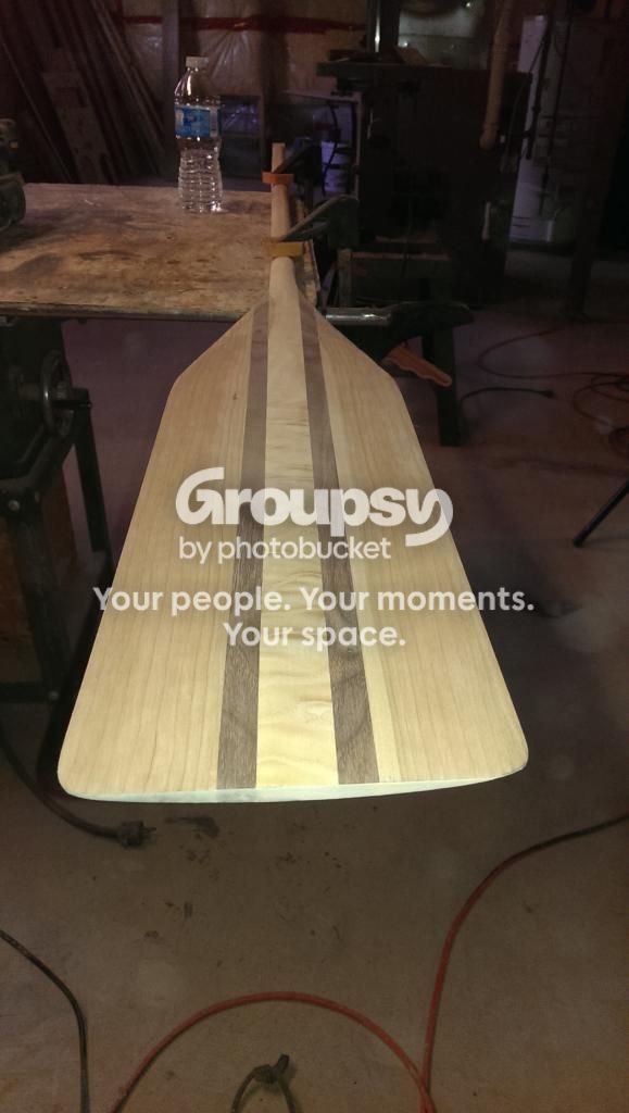

    Final shaping with belt sander. 120 grit used
