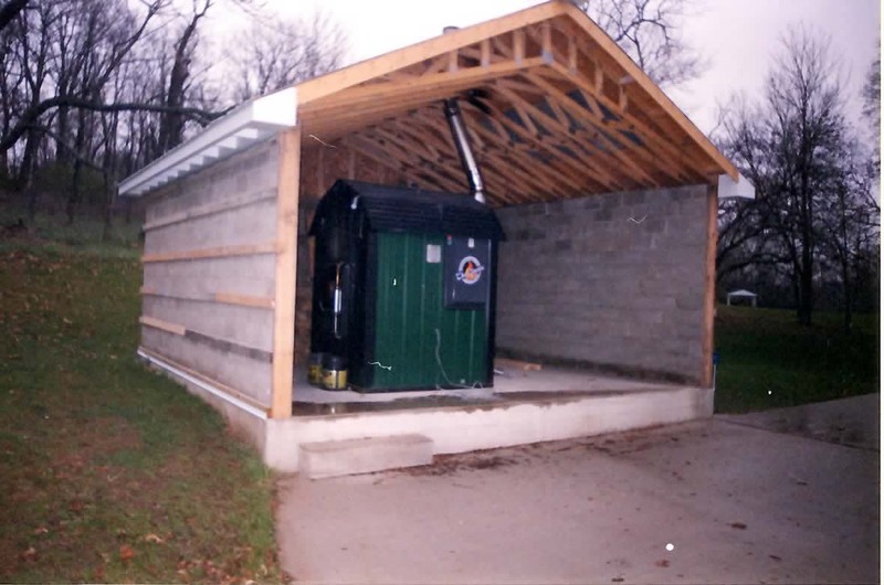

    I'll give you a lengthy reply! LOL I have a stainless OWB and one advantage if you want it inside is you don't need to insulate. I made a 20' x 20' building but in hindsight a little bigger would be nicer. I like to get all my wood for the heating season in there. I do still but if was bigger it would be easier to move stuff around. of course that all depends on your heating demands. I'm heating a well insulated 36' x 50' 2 story farm house with full basement, 36' x 50' attached garage with 2 zones of radiant floor heat and all my hot water. Averages around 13 cord for 14 years of use now. 1st year with no insulation in the house was 29 cord!
    I used block on 3 sides with filled cores so easy stacking and no bug issues. Front is stick framed and screwed/bolted together so I can get the boiler out easy if needed. Door was made for easy loading and walking into the bed of a normal truck.
    My goal was to have it blend in so most won't even know it's there.
    Pipe is run underground into the basement under the new garage floor.

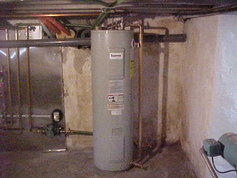

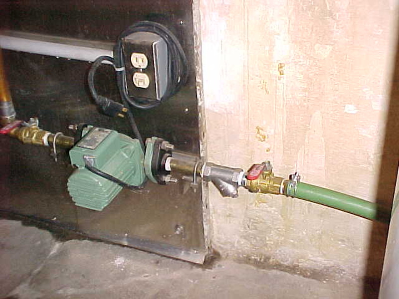

    When it enters it goes to the main pump you see near the floor. You need to have an expansion loop as mine is one the ceiling before it comes down. From the pump, it goes to the water heater. Simple side arm. I shut the valve off when heating season is done and switch the electric back on. Easy an trouble free.
    From there it goes to the lowest pipe to the zone valve for house heat. I have an hot water oil furnace with one thermostat. I run 7 plate heat exchanger. I kept that a quick easy install as well. Tied into the house line and it runs to the heat exchanger. When the house calls for heat, 3 way zone opens and exchanger works. Oil furnace pump runs 24/7 along with wood furnace pump. The oil furnace running constant keeps it quiet and the heat up and down is gradual. No tinging if you will.
    The 2 zones in the garage floor have their own pumps and thermostats. You can see them on the left (orange lines) and returns in the middle. from there it goes back to the boiler.
    A mistake I learned that I did was the heat exchanger is mounted wrong. It should be up and down as opposed to flat as I have it. Being flat will cause it to plug quicker I was told. I just replaced mine after 14 years. It was still working but couldn't keep up in extreme cold. I'm going to try to clean it out for a back up.
    Another thing I was not told to do was to install a strainer. I had an pump impeller(cartridge) die and they are plastic. Send the remains on into the system. I put one in now after the main pump. That leads to another suggestion. Put valves everywhere. I have a lot as you can see and it makes fixing things SO much nicer. You don't have to drain the system and priming/air in system is basically a non issue.
    I used all poly, brass, copper and stainless in the new system to keep corrosion issue low. I've added water one time in 14 years and a 1/2 gallon on corrosion inhibitor in all that time. A month ago my dealer hard tested my water and said it was borderline and to add the rest of the 1/2 gallon and he said it looked amazingly good. I attribute that to the materials used. For this reason I'd highly suggest to keep you systems separate like I did. This will allow you to fix you house system at a later time if you insist on updating. I would try it first to see if it will be okay to live with. The way I have mine, I still have the oil furnace as a backup if needed with basically work involved.
    Feel free to ask any questions. I am not a pro at this and don't claim to be. This was first install and I did it before I had any online help. My dealer was great, luckily. I would have killed to have what is available here now.
