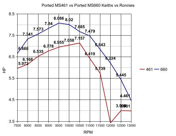

    The 660 is a cool saw bit in 20" wood the 461 will beat or hang with the 660 but be lighter.
