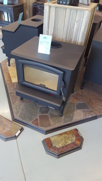

    Thanks guys! Here's what I'm working with:
    Ss liner to be Tuesday and Mason will be over the next rainy day to finish the brick to fill in the fireplace and the wall behind the burner. I will then lay a subfloor on top of the wood and set tile for woodburner to sit on.

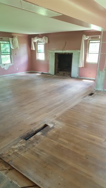

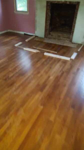

  2. Born2Burn
    Born2Burn
    Jun 20, 2017
    349
    1,875
    Youngstown, OH
    Before the floor was refinished. That last picture was horrible!

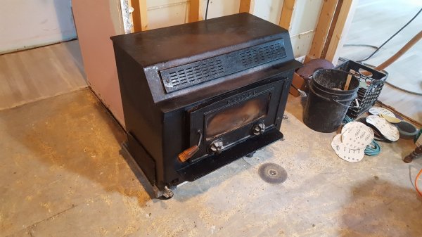

  3. Born2Burn
    Born2Burn
    Jun 20, 2017
    349
    1,875
    Youngstown, OH
    Original Brunco insert that came with the house in that same location. I had originally had high hopes of using this old smoker but after realizing that even though I live only a few miles from the manufacturer and necessary parts are no longer available, I opted for a new efficient model.

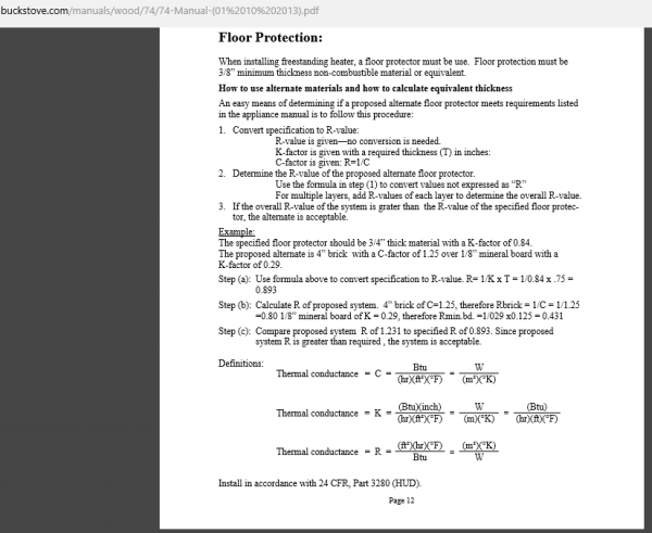

  10. brenndatomu
    25,375
    165,372
    I looked up the manual for a Buck 74 to look up required R value.
    Here is a snip of the relevant info...it appears that your 1/2" cement board should be fine...they don't seem to give you a required R value outright...must be a non issue with this model! :yes:

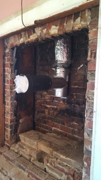

  14. Born2Burn
    Born2Burn
    Jun 20, 2017
    349
    1,875
    Youngstown, OH
    I knew installation would require the 2 90's from the conception of this project, but I hope it drafts well and doesn't create problems.... Oh well, it's going in and I'll report back later in the burning season with my results.

  18. brenndatomu
    25,375
    165,372
    Yeah, and having the first 90 immediately on top of the stove could be an issue too...generally 18-24" straight up is what is called for before any elbow. If your chimney has strong draft it should be fine though...I hope

  19. Born2Burn
    Born2Burn
    Jun 20, 2017
    349
    1,875
    Youngstown, OH
    I have not considered an OAK. In fact, I've never even heard of one until a few weeks ago when I joined up here on firewood hoarders. I haven't done quite enough research to fully understand if I would want or need one, and I also don't know what installation would involve. I will look into it though.
    I agree. It could certainly be an issue but it was setup by a highly experienced chimney sweep that the dealer, an unrelated general contractor, and a friend highly recommended I use for installation of the liners and burner. I have to think that if wasn't going to work or if it was a big no no, he wouldn't have set it up the way he did. That being said, next time I'll try for straight up and out!
