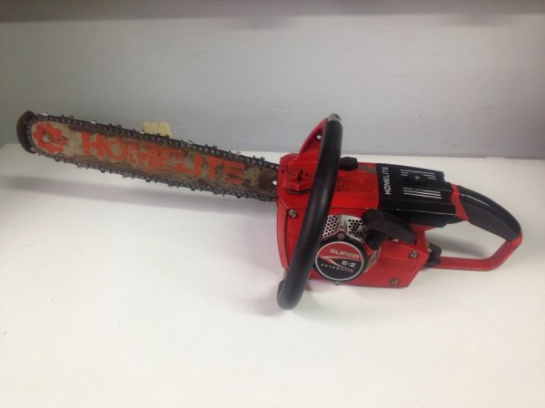

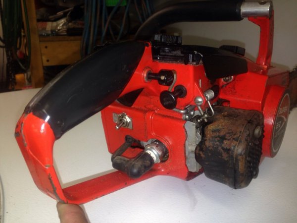

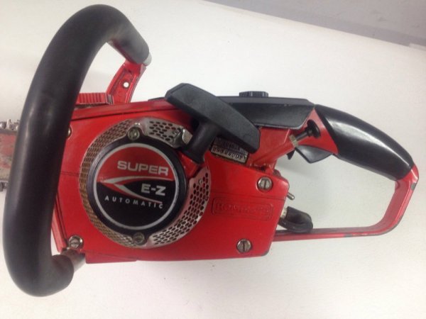

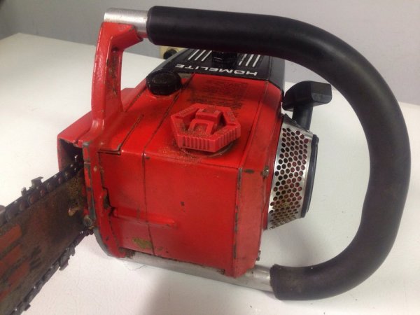

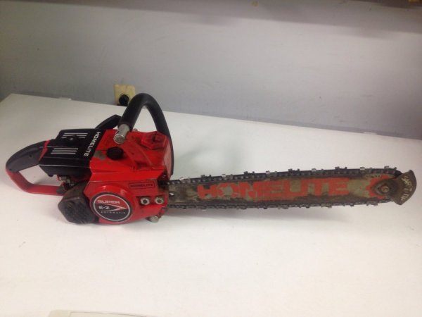

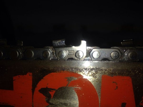

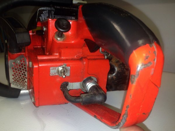

    Snapped up this sweet little Super EZ Auto to compliment the 1050 in my collection. Bought it as a non-runner, didn't take long to get it up and running. New fuel line and a little carb cleaner in the carb to free up some stuck diaphragms and needles and we were off! It's pretty similar to my Remington SL-9 so I guess I should do a comparison vid eh? :rofl: :lol:
    This saw while not in flawless cosmetic condition, is is very good shape. Came with the original case (beat up) and almost all indications suggest it is a super low-hour saw. The grips are flawless, showing no wear at all. Some paint chips, most minor. Had what I believe to be the original bar on it, complete with the safety tip guard. Also wearing original Homelite branded chipper chain. The only suggestion that this saw has been used for any amount of time is the nearly worn-out spur sprocket and a paint chip the size of a nickel on the top.

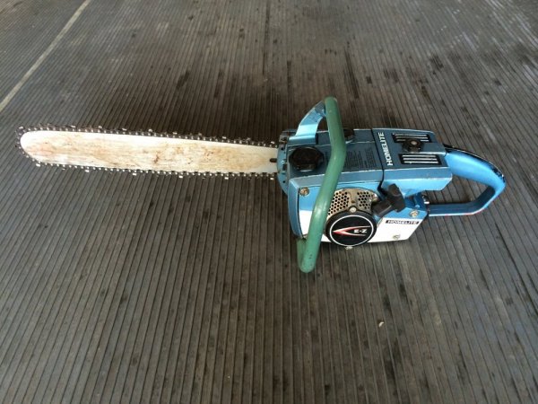

    Wow Gary, that one looks nice. Where did the green wrap handle come from?
    I wouldn't mind a blue EZ for the collection either. They are some of the best looking vintage Homies IMO. They should have stuck with that color scheme if you ask me.

    The green handle was on it when I got it (and notice the CL saw linked to above seems to be the same color). That was a Homelite color back into the '50's.

    Has a combination decompression valve and throttle lock seen on the right hand side of the back handle. It actually needs the decomp, she yanks back pretty hard for 40cc without it!

    Mine is identical to yours in every way Gary, even condition. I found it at a farm sale a few years ago, it is a nice runner- and loud!
