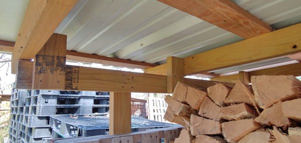

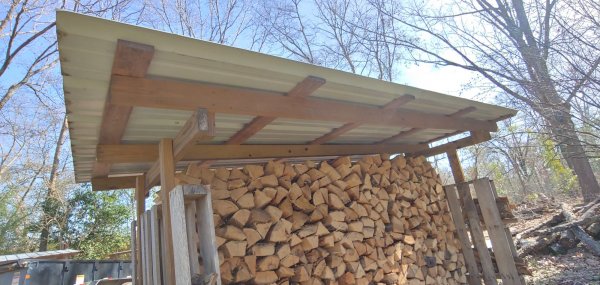

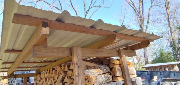

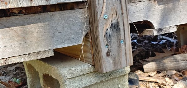

    I got better pictures today. I usually try to improve the design each time I build ba new one, like 2x6's for the uprights and 2x4's instead of 1x4 cross pieces. Also I usually use 4" solid cap block on the ground, with 4x4 across (front to back), then the 2 long 4x4's fastened to them. It will be a bit shaky when empty, but very solid with wood in it. 0120201228a_HDR.jpg 0120201223a_HDR.jpg 0120201224.jpg 0120201228_HDR.jpg 0120201227_HDR.jpg 0120201227a_HDR.jpg

    What is the size of the roof you put on this? Is the material a standard 4'x8' or larger? Does that overhang keep it pretty dry? The 2 ft. (depth) plywood that I have put over my firewood does a reasonable job of keeping the wood dry but might have been better had it been 3 ft. in depth. A shame you can't buy sheets of plywood 3 ft. in depth. ;-)
    I also noticed that you double row the wood. I have read places where they discourage that. Has that double rowing caused any issues drying the wood?
    I can see a number of pros to double rowing including twice as much storage for the same linear feet. Also I am sure it is more stable than a single rack where I have had to uses posts to make it more stable.
    I occasionally have been able to find pallets made of 2X4 that would obviously be stronger.
    Thanks again

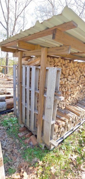

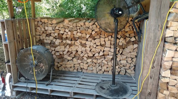

    I am using 50x50 pallets, with 3 18" rows of wood stacked on them, total 54" wide. I had to use a little wood off that rack, made it easier to take pictures. Never had a problem getting the wood dry like that, but a double row would be better, we have hot summers down here. Put fans on it until we get the rack full. IMG_20190717_121607178.jpg The roof is 36" metal roofing panels 10' long, seems to work fine. If you support the pallets on the bottom, they should be fine, we have several like that, no problem. Just build one and try it, think you will like it. If I can help any way, just ask.

    Now I am confused.
    If you are using 50" pallets is it 2 50" pallets in depth if you want to have 3 rows of 18" wood that would be 54" in depth.
    Are you doubling the 36" roof panel to have a total roof over this of 72" in depth?
    Please clarify if you can. This looks like a good solution to try.
    It is also interesting having fans you use. My piles is a ways from the electric so doubt I could do that. I do get a lot of wind here.

    Ok, sorry I got confusing. The roof is 2 panels wide for a total roof size of 72" x 120". On the pallet issue the floor footprint is 50" wide x 100" long before putting ends on...probably 94" when complete. I just let about 2" or so hang over the sides to get 3 stacks wide.

    That cleared up the confusion. Thanks
    I will look at setting something up like that.
