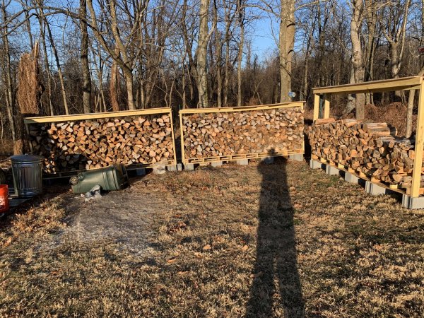

    I have two storage areas. This area was made with some recently found 10 ft. rectangular pallets (ideal dimension for wood storage). I have covered them with 2 ft. wide sheets of plywood going the entire length. I have also supported each pallet on both sides with metal posts. I also have them up on concrete blocks as you can see.

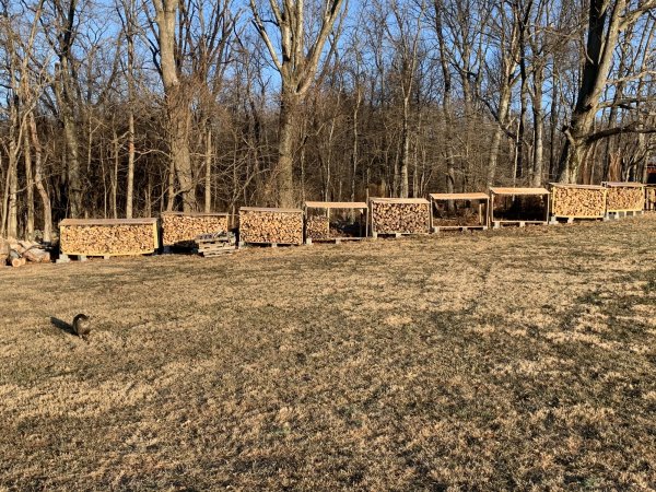

    This is my other area:
    The above are built different ways. My original ones were built on a base of 8 ft. 2x10's laid horizontal with matching 4 ft. sides. Knowing what I know now not the best configuration with a wide bottom.
    Later ones were built using a firewood kit (see URL).
    One thought I have about my firewood supplier who seems shocked at my storage is maybe it looks like more firewood storage than it really is (as I said before it is around 5 cords).
  13. The Wood Wolverine

    Very nice stacks!

    SteveWest Welcome to the site. Great pics of your wood supply. Looks like you have a good amount of room to put in more wood racks to help you get to the3 year plan.
