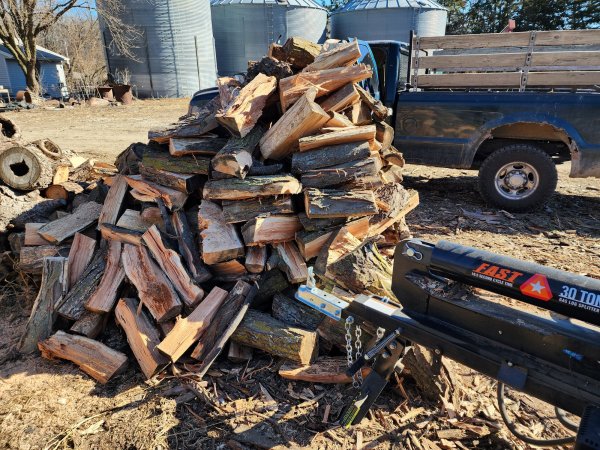

    We replaced my Country Line 25-ton that died in a fire New Year's Day 2022 with the CL 30-ton. I tend to run it around 3,000 RPM and it is plenty fast for my needs. I think my only complaints are the axle is too far forward in the operators area, the jack stand is overly complicated when moving it myself plus it is heavy. Looking at trailer dollies when I get a few dollars ahead. 20240218_143547.jpg
