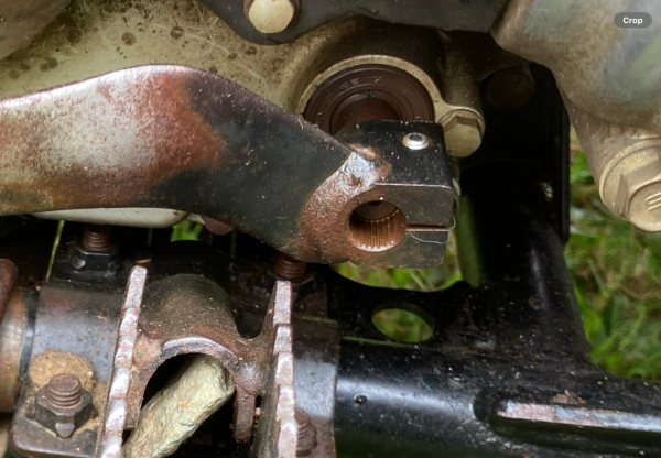

    Is the shift lever loose on the splines? From your pic it appears to be installed correctly.
    If its loose on the splines, slide it off and clean the splines up, then lube them up with some WD40 type oil, slide the lever on until the pinch bolt can slide through the narrow spot on the shift shaft, then tighten it down until shift lever clamps tight onto the shaft...if the pinch bolt is stripped you can put a longer one in with a nut on top.

    She’s oiled up and not stripped. Shot it with oil a few times over the course of several days before I attempted to back that bolt out. I remember from my dirtbike days just what a pain they could be. It’s a new bolt in there now. I think the old one was ready to snap upon removal,,,,not worth the risk. It’s as tight as I dared make it which is usually a few lbs away from snapping,,,the universal shade tree mechanic torque setting :)
    It’s a little wobbly on the shaft. Mostly wear in the shift lever not the shaft itself. Came wobbly and it’s still wobbly after I removed it, cleaned it up, checked it out and eventually reinstalled it as is. Had replaced the battery on the Polaris,,,was really hoping a weak battery or dirty connections was the culprit in the computer getting weird signals. No luck, threw the code again so it was back to the Honda el pronto.
    If you look close you can see how much shaft is inside the lever,,,how much shaft is not utilized behind the lever. Obviously for clearances it needs to be that way with this particular lever. I’m not sure if it’s stock or was replaced somewhere along the line with a more generic one that will work but not 100% correct. It’s possible even Honda did it this way to have levers fit several different machines.
    In reality if you could, you can’t but if you could, flop that lever backwards onto the shaft all the splines and pinch bolt would match and be utilized. Right now it contacts 50%.
    I’ve come up with several ways to make that fix but not right now. I’ll also use a brand new lever to chop up and rework. One that has nice new splines inside.

    That lever is very non Honda like in that the shaft is not in full contact with the lever. Most toys like this have a shaft that has a radius ground in the center of the splines to have a bolt go in, to aid in retention. The lever can't back off the shaft unless the bolt falls out

    That is the stock Honda lever, I dunno why they did it that way, but they did.
    And the shift shaft does have the notch in it for the pinch bolt, does it not jo191145 ?
    Hopefully the shaft splines are not worn too bad and a new Honda lever will clamp tight on there...these are just like the splines on the rear axle/hubs, gotta keep 'em tight and not let them get loose/rusty...things wear quickly when that happens.

    Yes it has the notch for the pinch bolt. Not sure why they did it either. I can understand moving the pinch bolt back away from the weld as it’s easier to pinch but they should have designed the shaft to fit the entirety of the lever.
    There are other aftermarket levers built with the pinch bolt closer to the end (weld). But they also have less meat further inside so in effect it’s the same amount of contact you just don’t see that void. Judging by the online photos I’m hesitant to believe there’s enough clearance as that shifts the lever further into the bike.
    I could modify one of these style levers by just using the female spline shaft section, welding some extra tabs on and drilling another one or two bolt holes. Possibly modify the notch bolt if needed to leave it incorporated. Then reweld another piece to come further out and accept the hand shifter. That hand shifter is another wonky design but I knew that when I bought it LOL. No reason I couldn’t modify that myself or start from scratch. There’s a whole lot of travel to it. By moving it closer to the shaft it should reduce a little of that travel.
    All in all it is just a wood tractor after all. No need to get too fancy :)
    I wonder if this lever came off the original 2wd model and when they made the 4wd model with transfer shaft in the way they just changed the shift shaft to protrude further and kept the original lever? Would be odd

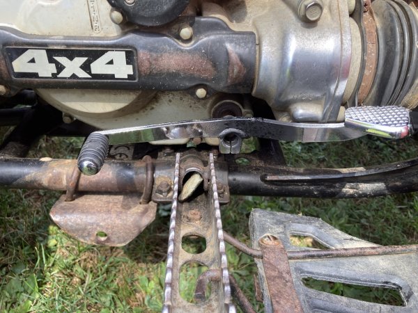

    Nice shifter Joe! Those auto clutches take some serious effort to move. I really like to have steel toe boots on (or back in the day, dedicated riding boots) to shift it. Even running full synthetic and the engine up to temp, it just takes a lot of effort. Probably because you’re not only shifting gears, but actuating the clutch pack as well. I’ve seen some posts on the internet/FB from guys who installed a secondary hand clutch to help with shifting. But that’s a lot of work.

    Hmnn, mine is almost effortless to shift. Of course by foot I’m only downshifting and using the handle for that now too. To upshift I used to have to stop, reach down and upshift with my hand. I have noticed,,,or so it seems, you need to wait for the RPM’s to slow down before shifting. Not just let off the gas but wait for the engine to slow down quite a bit. Anyone trying to go fast may have different experiences, I could see that.

    Some updates. Looking at all the possible shifters,,,,mostly junk on the market I opted for a foot shifter like on a Harley. Judging by the photos it had what I was looking for in a spline that matched the bike and push come to shove could be reworked by cutting and adding whatever was required to make it work.
    Turns out it just needed a partial cut through with a cut off wheel, a bend outwards in the heel and a quick bead of 7018 followed by a heat quench with black paint :)
    Works better than a hand shifter. I like it. I do understand what you folks were saying about hard shifting now tho. Without a 20” lever it’s tough.

    Yup, that's the clutch pack springs you are compressing...with your foot, which is fine pushing down, it's that lifting up part that gets most people.
    I've always thought that someone in the aftermarket should come up with a hand shifter option for those...basically just a clutch lever like what is on most bikes (and a button or lever to control the shift up, or down) which that works fine to compress the same kind of clutch springs, so...
    I really don't think the act of the "gear shift" itself takes that much power, but certainly the two acts combined on that foot lever makes it a challenge, especially if you have ankle/foot issues!
    Nice solve! :thumbs:
