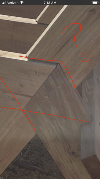

    Got any pics of the joints prior to assembly? I'm building one of these masterpieces!

    This is pretty easy with an radial arm saw also. I usually use my circular saw as described. Keeping the repetitive cuts less than 1/4” apart. 1/8” is better.
    Then smack em out with a claw hammer using the claw to rake out the loose pieces and then my timber frame chisel (shaving sharp) to clean up the bottom if needed. (Usually not much).

    Pretty much spot on with what Lennyzx11 stated... I think I explained how we ended up doing the final touches with one of those fast oscilating hand tools.. Just a little cleaner and easier...

    It’s that “inside corner” with a circular saw that’s driving me bonkers. The straight cuts at lower left are logical. The corner at upper right must have been multi-tooled? (oscillating saw)
