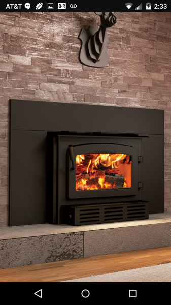

    Like Horkn said you can easily do it yourself. I did. That 1400 included the stainless liner and an angled exhaust fitting I needed to make the connection.
    Is it heavy? Yes, but my wife and I didn't need any other help, and she's not exactly a body builder at 120 pounds...
    I'd recommend a dolly-for moving it around while still on the pallet , an angle grinder, an electric drill, a metal saw, and an adjustable wrench for changing the height of the feet. It's pretty easy.
    I went with the insert to get more heat out of what we had... I did not want to rip out the fireplace. We like how it looks, and the 1800i allows us to keep the look and style but get serious heat out of it.

    Menards is doing the 11 % thing this week... Search around and u should be able to get brand new insert for 900 ish.

    Yeah, that drolet 1800i is a great deal, and a great big window. I know you've got Menard's around you. A SS liner kit is about $400.

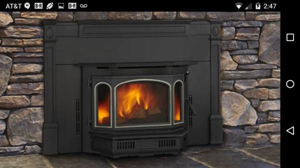

    Here's a close up of the quadrafire 4100
    There's other quadrafire inserts that passed my wife's very discerning eye test.

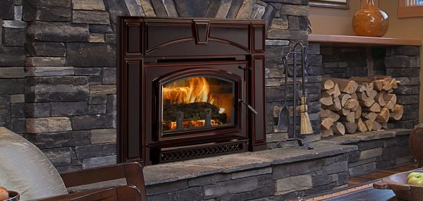

    The grand and regular Voyager are beautiful stoves.
    But there's other bow/ bay window quadrafire inserts.
    There's other brands too, that are good. But most are pricey.
