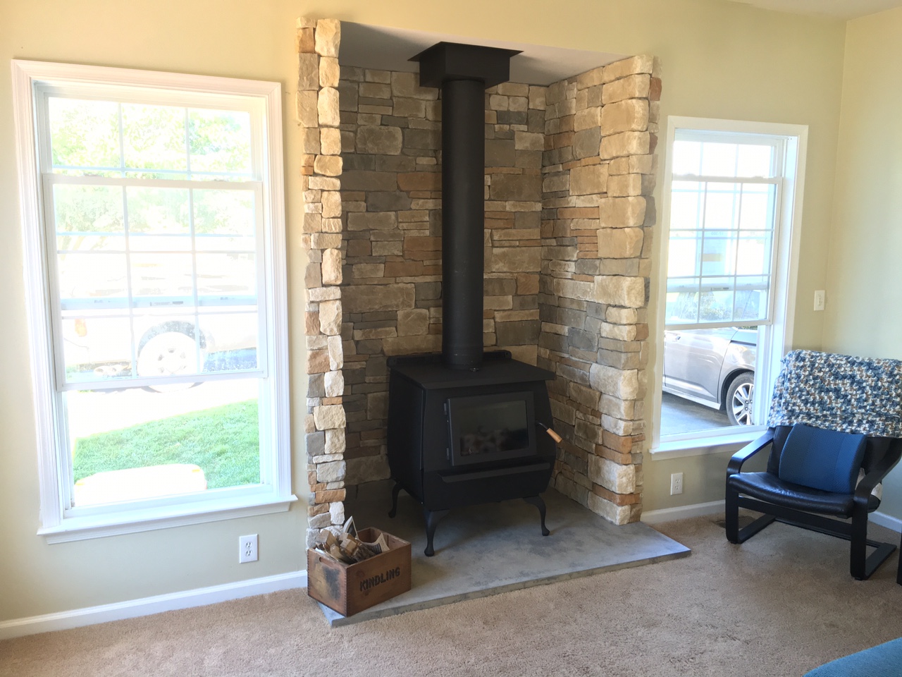

    My project cost me $14k total, and pretty much every spare minute of my time for 2 months straight. I provided almost all of the labor, with the exception of the stone work which cost me $2,600, materials and labor.

    Here is the end result of one member's conversion to an alcove install.
