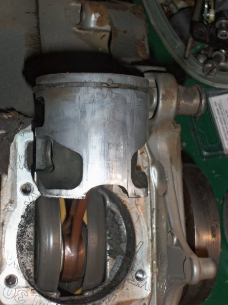

    This is a known issue to people who deal with the 562 daily, be it dealer or cutter. C5rulz might not be a logger, but he don't run dull chains.
    if you check the IPL there are updated air horns for the 562, dealer should be aware of this, mine was anyway and gave me a new air horn for one of my 562
    here is what eventually happens- picture of a saw torn down for warranty at the dealer some time ago
