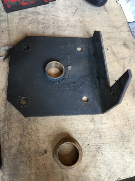

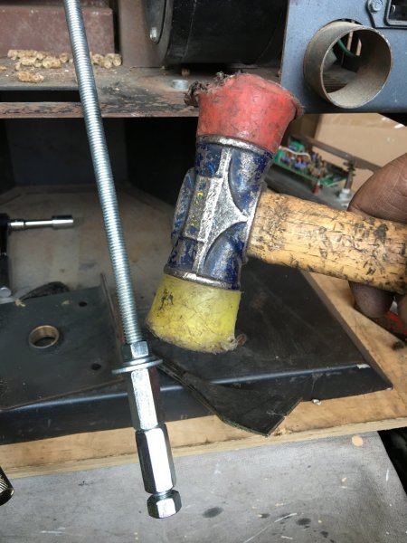

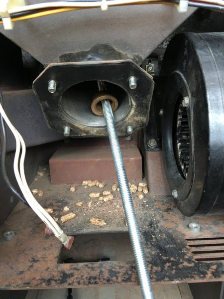

    Just a few parts for approx $5.00 from Home Depot and Bingo! Easy Peasy

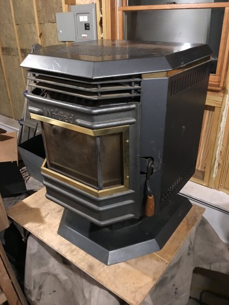

    Stove is a Whitfield Quest.
    Note: The Whitfield Pellet stoves have a 3/4" diameter auger shaft where bushing resides, one of the main reasons it is such a great stove!
    Therefore, I choose 2 feet of 3/8" Threaded Rod. I did use extra thin nuts and put the grinder on them to fit 5/8" auger shafts
    However, If your stove has a:
    5/8" auger shaft for bushing, I recommend 1/2" threaded rod
    1/2" auger shaft for bushing, I recommend 1/4" threaded rod

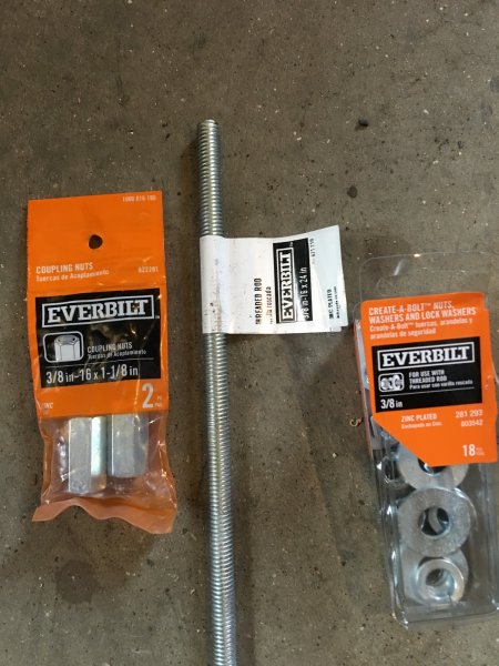

    Pic 1 - Threaded Rod , Nuts and washers , coupling nuts

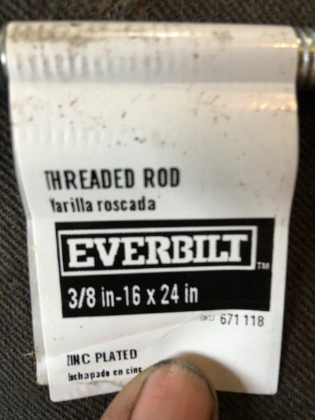

    Pic 2 - Threaded Rod Tag

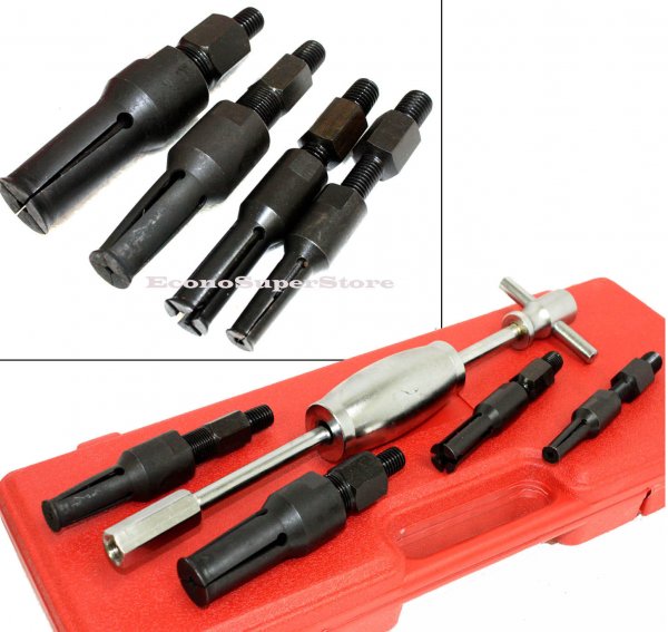

    Pic 3 - Assembly completed

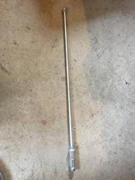

    Pic 4 - Insert tool and a few taps

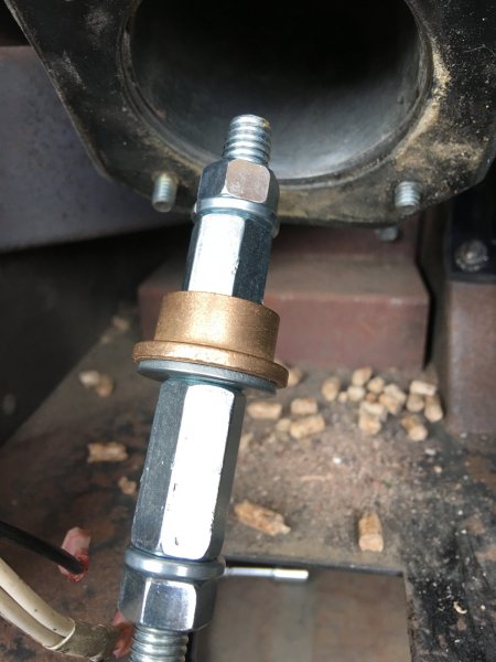

    Pic 5 - Bingo - bushing slides down
    Pic 6 - Dry and dirty auger bushings

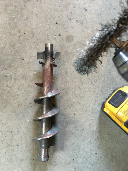

    Pic 7 - Dull, Dirty and rusty auger with auger pox! (Sharp bits of welding slag that rip pellets)
    Pic 8 - By flipping the tool around, Inserting a new top auger bushing with a few taps is Easy Peasy!

    I ground down the auger pox (sharp splashes of slag from sloppy welding) and buffed out the auger and sprayed it with dry moly, then I put in a new bronze top bushing, then upgraded the bottom bushing to Nylatron per Dr Whitfield's dealer technical bulletin. :)
    That heavy Stainless Steel 3/4" diameter auger and permanently lubricated hardened high temperature Nylatron bearing make it by far the most rugged Top Feed auger system in the Industry! I wish other manufacturers would learn from that! The early Enviro EF-2's have a 3/4" diameter auger and are still working fine! Maybe they wanted the stoves to break down and realized the 3/4" diameter augers were just way too good? ! ! ! What do you think?

  4. jtakeman
    12,310
    55,497
    I had to change one a few years back for a bud. I used a slide hammer to pull it. A free loaner from the auto parts store. Same place I got the bushing from. I used a long extension and a socket on bass-ack-words to reinstall.
    I do like the threaded rod to reinstall.
