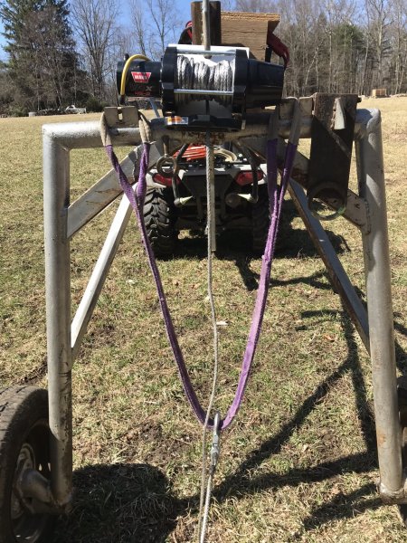

    Work looks solid. Just got a welder myself about a year ago. Been making all sorts of gadgets to make life easier.
    Now I didn’t build this myself. Bought it used and did some mods. Originally had one of those hand cranked boat winches on it. Didn’t like that at all. Pushing a button is so much easier and faster.
    This is just a little stick I put on it after replacing the leaky tires that came on it. Was just to put some weight on it to let air out of the tires. A log arch is quite safe all things considered. Haven’t had much use for it yet as I have a ton of wood to process already. Biggest log I’ve carried was 16” x 16’ with just the atv. Can hardly tell it’s there as it takes all the weight. Your sawmill blades will thank you as there’s no need to drag anything.
    Strap in the second pic is just me toying with an idea for hoisting logs sideways up the back for bucking off the ground.

    What size winch do you have on the arch? I'm looking at putting a winch on the sawmill for rolling the logs up the ramps. It won't be making a full dead lift like on an arch, so I'm thinking I can get away with a smaller, less expensive one, although it will probably be a little slower.

    The winch on the arch is a 4500lb Warn. Perfectly fine for that application. You mentioned rolling up ramps. The arch is used similarly where the rope is stung under the log and connected above. The log rolls up the rope as it tightens. I use tongs to fetch them.
    I have a 5500lb Superwinch on my dump trailer. Impressive unit.
    Also have a Polaris 3500lb on the atv. Nice feature on that is a rapid retrieval mode. Basically a high gear. Not supposed to be used for any pulling but if your needing a lot of rope in and out it’s nice. Seems the smaller winches designed for ATV’s have a habit of getting the ropes bound on the small spools. Pulling them out by hand can be a chore.
    I seriously considered some of the economical winches for my needs. Luckily before I took the plunge on any of them I happened along some quality used ones for cheap on CL or FB marketplace.
    The 5500 was ever used sitting in the box for years.
    The 4500 was lightly used by some guy who used it for physical therapy on his shoulder. I laughed at the insane possibilities if something went wrong :) Who would want to tie a 4500lb winch to their arm?
    One thing to look for is comparative horsepower of the motors and then gearing ratios. The cheapies use underpowered motors and low gears to make weight. So they are slow and prone to burning out. Some cheapies are very underpowered so it pays to compare specs even if going with budget models.
    All mine have synthetic rope instead of wire. I like the rope. Only drawback is it doesn’t like abrasion.
    A set of tongs and you may be better off just pulling them up instead of looping around and running the hook back to the mill.

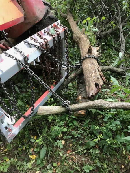

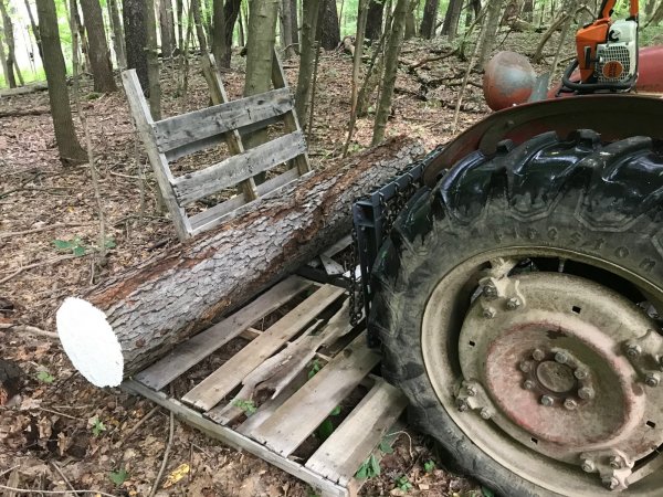

    I'm cleaning out and adding to a ditch through the woods and thought I better drop som EAB kills so I don't bump them with the tractor while working and knock some limbs out of the top on me. I pulled this one out to make some firewood, it's 40' long and 18" at the stump and 8" at the top. There's another 20' of smaller above the crown that is solid also and will make some nice heat in the house. This one is still small enough I didn't need to use the clinch hooks I welded near the bottom link hitch points of the skidder. I added those for pulling out large saw logs to keep the front end of the tractor on the ground.
    Not a pretty paint job but it get's the logs where I want them.

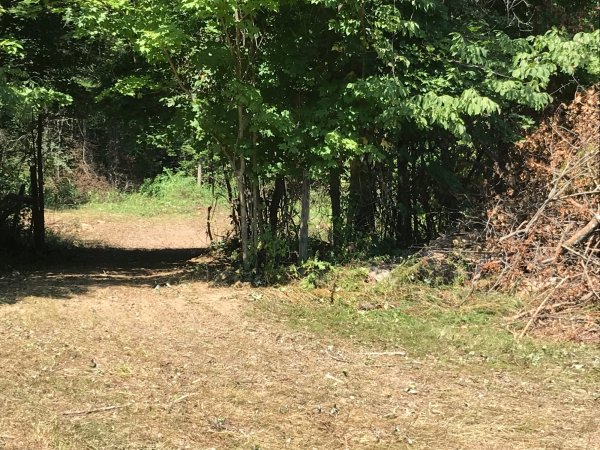

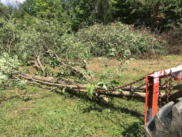

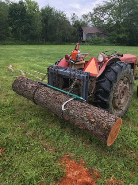

    Playing with the skidder again this evening to clear out a few acres to plant Walnut trees next spring. It's working pretty well. I go through and cut the stuff I want to remove and then bundle them up and pull them out to the wildlife habitat stacks.
    I bought these 2 20' chains 25 years ago and they have proven a great investment over the years.

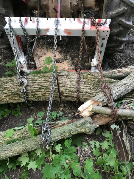

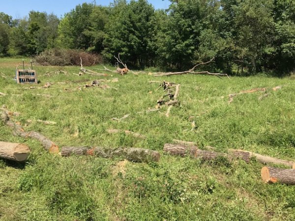

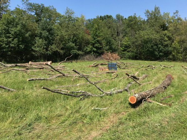

    I've been busy this week clearing some of the trees out of the area we want to plant walnut trees. Clearing out the underbrush completely and culling out Locust and crooked cherry trees although one of the cherry will make a nice saw log.
    I decided I better get this cut and stacked so I would have more room to skid out some more stuff next week. I was hoping to get some help today to stack, but no one has shown up yet... I've had some help from family and friends to get this far and that help has been greatly appreciated.

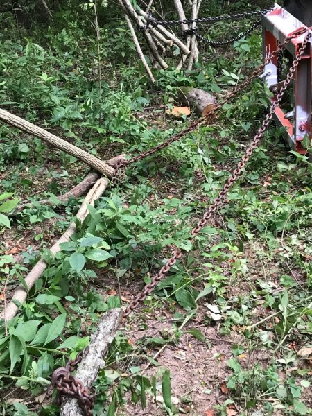

    The area all this is coming from is through a short trail into the woods behind the brush pile on the right. We drag the trees out whole and top them next to one of the piles and push the brush into the piles. The smaller brush just goes on the piles, but anything worth cutting for firewood is drug out into the field. There is a 22" diameter 9' cherry log that will go over the the sawmill. I hope it will dry well cuz this tree was a leaner. If you look close at the butt I cut off you can see the notch cut on the lower left, then a bore cut in the middle to set the hinge and holding wood on the back. Then the last felling cut to sever the holding wood at the back. I didn't want to lose the log to a barber chair. That 9' is the only straight part of that tree.
    This will get cleared out back to the river bank to make room for future walnut trees. I won't get to see them harvested, but I'm trying to leave it better than when we got it.
    Haven't even counted how many trees are laying there for firewood. I'm trying to get ahead into the 3 year plan.

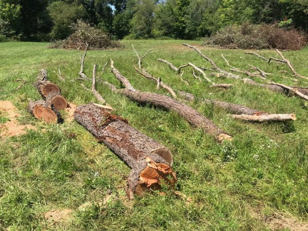

    Got about half of it cut up this morning. I ran 2 tanks of gas through both saws so far today. That's the hardest the saws have been run in a single day. Usually I cut, then split, then stack, but so far today I've just been cutting. Taking a break from the heat to post this, then I'm heading back out to drop a couple standing dead ash to finish filling the woodshed for this winter's heating.
