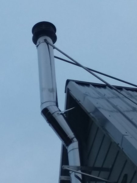

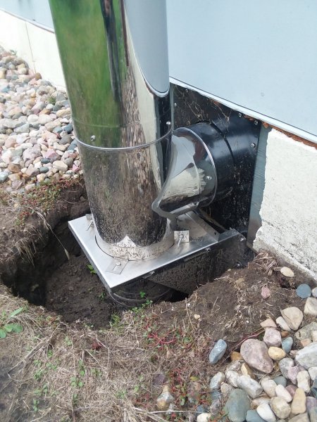

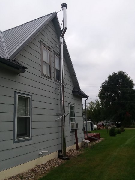

    Here is a couple pictures of my chimney

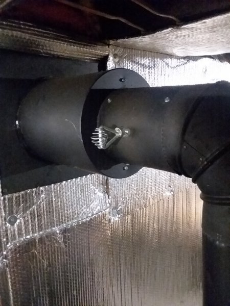

    Keep that pipe damper fully closed during non operation. May help a little to stop some of the downdraft coming down.

    My entire chimney is about 1/4 of what you have. That's a lot of cold, dense air in that. A sheet or two of paper won't move it, imo.

    My sister has a below grade chimney setup just like that...we had to put a steel window well around it and a steel roofing "cap" on it to keep the rain from filling up the pit

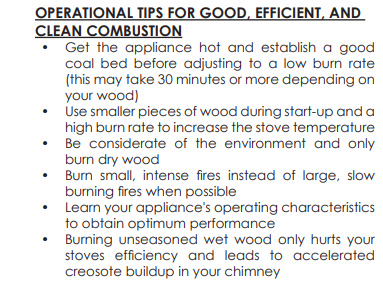

    Thanks. This seems odd to me where it says "adjust to low burn rate". The rest is too, "small intense fires instead of large slow burning fires".

    I'm seeing the combination of uncontrolled combustion air along with the exceptionally tall stack as a double whammy. Once that chimney gets drawing, the fire really takes off. The flue damper might help, but it's not the answer. Time to shop for a better stove. It probably won't cost as much as that stack did. :whistle:

    You say the stove drafts well when it gets up and running. This would indicate to me that your flue installation is OK. You have two stories above ground and the stove is in the basement. The problem arises because no house is air tight. The upper two stories are warmed by your primary gas, electric or perhaps heating oil appliances. This warm air is escaping via cracks and voids that any house has. This creates a small vacuum within the house that has to be filled. The basement now has this convenient cold air replacement ducting in the form of your flue pipe. The outside air flows down and in to replace warmer upstairs air that is escaping outside. A Flue damper would help to reduce this flow when the stove was not in fire but you would still have to overcome that slug of cold air in the pipe that starts dropping into the basement when you opened the damper to start a fire. Older and poorly insulated houses more commonly have this kind of problem. It is accentuated by the stove being in the basement. The smoke in the house at the end of a burn is from the reverse draft reasserting itself as the stove and basement cool and the upstairs are still warmer and bleeding heat. I think your only hope is in keeping the stove and inside piping warm enough to provide a constant slight updraft at all times. I have heard of draft inducers but don't know how they work. I suspect that they do much the same as a hair dryer or propane torch. The suitability of your stove is another issue entirely. Just my $.02 worth.

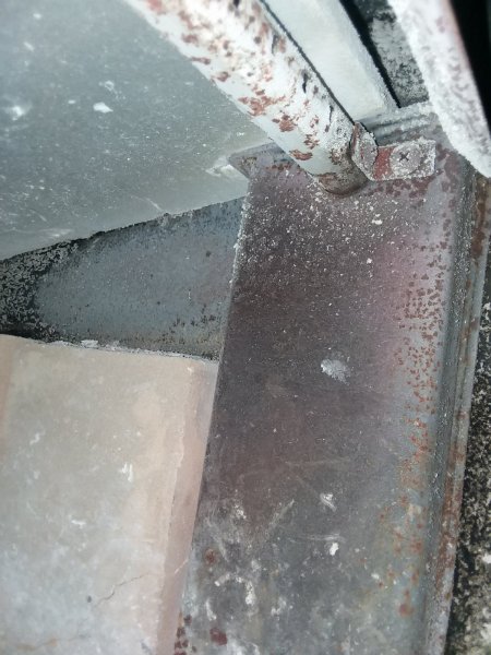

    Ok, so I'm going to try and answer everyone's questions as best I can.

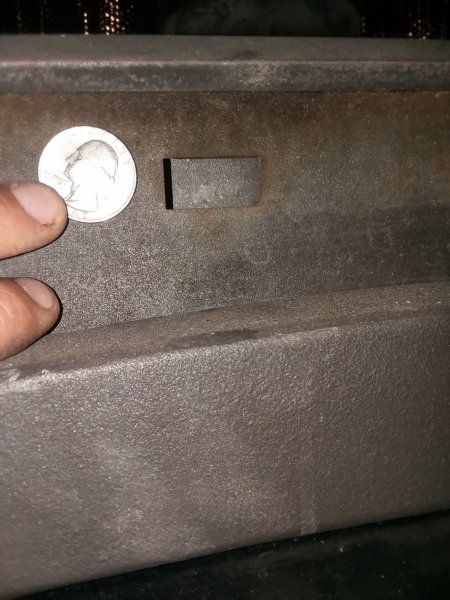

    As far as air controls on my stove.......there aren't any. The are 5 rectangular holes roughly 1 inch across and half an inch tall, (primary air)And there are 2 holes on the lower left and right sides, same size, that go into square tubes running vertically, then going into a thinner circular tube running left to right inside the stove (secondary air) Here are a couple pictures. I used a quarter for refference. 20191004_180051.jpg
    Ok, so the way I light my fires is to open the damper and use a couple 3-4 pieces of pine with some cardboard and newspaper and get a little fire going. After 20-30 minutes its usually made a decent coal bed and I spread that around flat. That's when I start adding my hardwoods. I place 3-5 pieces of wood in depending on the size, and after about 10 mins or less the fire is usually roaring. Everything in the stove is fully aflame. Then I close the damper and the flames visibly slow down. And like I said about 2 hours after that, flames are gone and I'm left with just coals. Then I open the damper move most of the coals to the front and reload. Closing the damper when most the wood is burning again.
    So metalcuttr, I think you are spot on with your analysis of my problems. And I bet my fire bricks cracked during extremely cold weather, a reverse draft making my stove extremely cold, then having a fast hot fire.
    One of the thoughts I've had is trying to figure out a way to plug the primary air holes in the front of the stove and having it only pull air in through the secondary air tube. But I have been stumped on how to do that successfully and multiple times.
