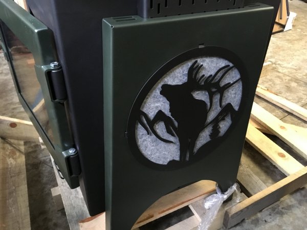

    The stove has arrived! The design was a mix of different designs we like. We are in elk country, so the the design feels like home. It will be quite awhile (months) before I am able to install it.
    I have one quick question. What wood length works best for the stove? I have a large hoard of logs stock piled from previous logging. As soon as we get a glimpse of nice weather I am going to start working up a few cord. IMG_0037.jpg IMG_0039.jpg IMG_0044.jpg

    Look at the back cover of your manual. The IS lists maximum wood length as 22 inches so I would stay around 20 inches just to avoid any issues.
