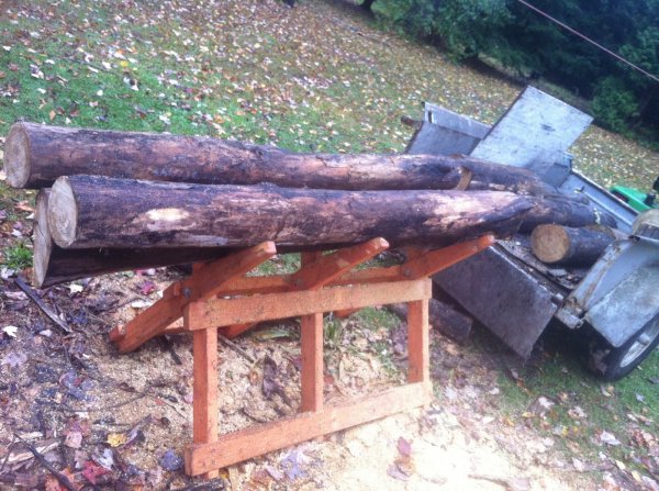

    Dunno how it would work out for you for log loads, but here's what I do and it works for me.
    I get all my wood from fallen trees in my woods, so I haul it out on this trailer. If I can pull right up to the pile, ill load everything up in large pieces and saw it up on the sawbuck back at the house. Once it's on the trailer, I can easily slide them onto the sawbuck. I designed mine to be the same height.

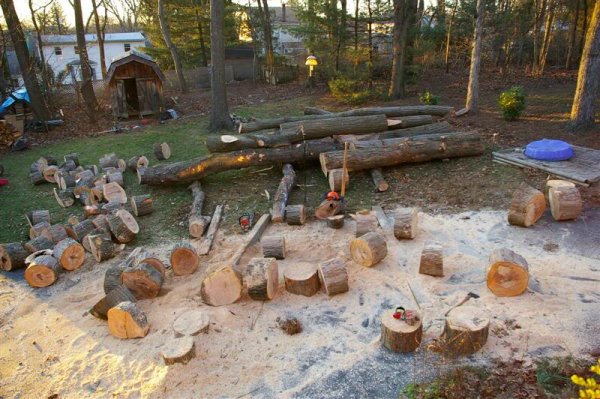

    Processing a log load will make a big mess. No doubt about that. It will destroy your lawn if you process it there.
    I get mine laid out on stringers parallel to my driveway then roll them out onto blocks on the driveway with a peavey and cut there. Cut till it is about to pinch then roll and finish all the cuts. Cleanup on pavement is much easier. The lawn just gets a few dents and divots. It's not all torn up. I also get the logs laid out flat as possible so it is rather easy to pic apart with a peavey and pry bar.
    A load from a while back, stringers and 6x6's to cut on.

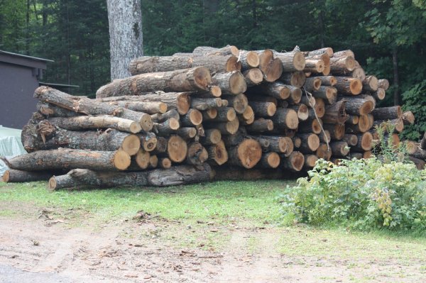

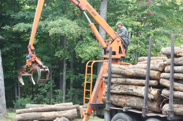

    This is how we do er' up here. As BD said, have the driver lay a half dozen or so on the 90 and stack on them. Firewood Delivery 15 Sept 14 004.JPG Firewood Delivery 15 Sept 14 002.JPG
