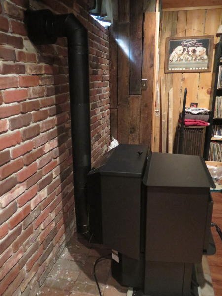

    True that I just spent $ 500 + for my new set up :bug::bug::hair:
    BAN83, eatonpcat, ivanhoe and 3 others like this.
