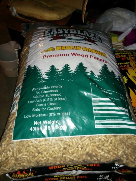

    Hey Steve I have a concern about my shipment . My 2 test bags were a very light blonde color and 1/4 - 3/4 in length. But when my 2 tons were delivered they were darker in color and 1 - 1 1/2 inch in length. I'll add some pics. Test bag .
    imacman likes this.

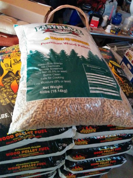

    Delivered bag .
    ttdberg and imacman like this.

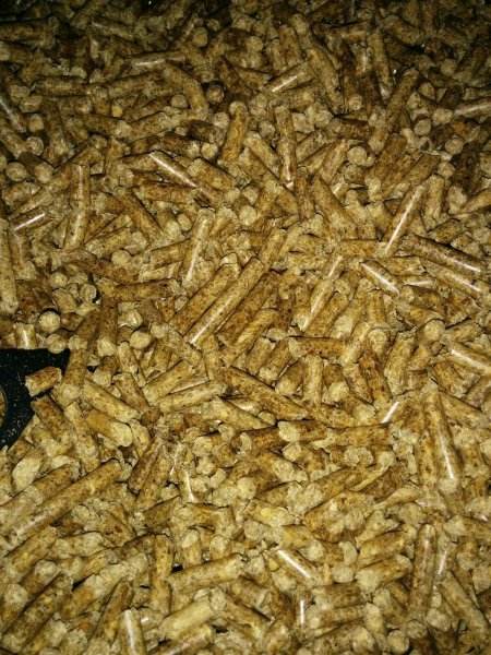

    This is a bag from my 2 ton delivery . Not the best pic but I think It shows the difference.
    ttdberg and slvrblkk like this.

    The darker pellets could just be from the die temperature when the pellets are extruded....possibly.

    I understand that but how about the big length difference.

    PFI spec says not more than 1% can be longer than 1.5 inches. That's roughly 0.40 pounds. So technically they can have a few long ones in the mix. But if you tally more than the 0.40 pounds they are out of spec.
    My quad didn't care if they were long nor does my Omega. But the Breckwell I had would bridge in the hopper and cause havoc! It also would make a heck of a ratchet when trying to feed them. Not to mention it killed the heat output even if it did feed them. I couldn't afford to run long ones in cold weather with that stove!! Not all stoves will be effected, But it does suck for the ones they do effect!!

    I did run the Quad last night with no problems and there was little ash but we're talking maybe 1/3 of a bag . I also broke up some of the long pellets just to be safe.

    Roughly 1/3 over the 1.5" inches?? Wow, That would be an issue for some!
    Wonder where steve gordon is at?? Curious to hear his thoughts!!
