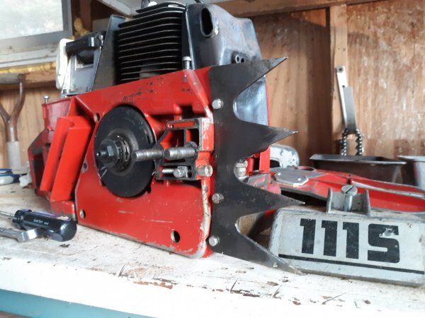

    20191212_160804.jpg Big dogs. These make the dogs on my 7910 look anemic.

    Those look like the dogs on my 3100G homelite

    Theres two different sets of dogs for the 111s. The other kind are much shorter with more teeth. The saw might be for sale soon as I dont have the time or skill set to properly restore it.

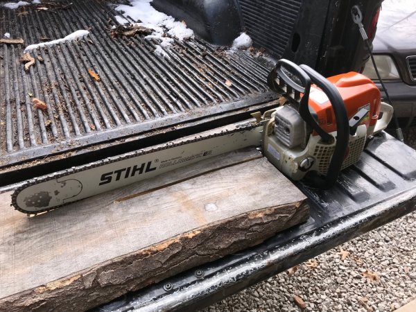

    I replaced the dogs on my MS250. The stock ones didn't get much bite felling stuff with knarly bark.
    Before... where's the beef???
    After, I actually ground some of the sharp edges back some. They were too sharp and bending a tad and I would catch them on my chaps occasionally.

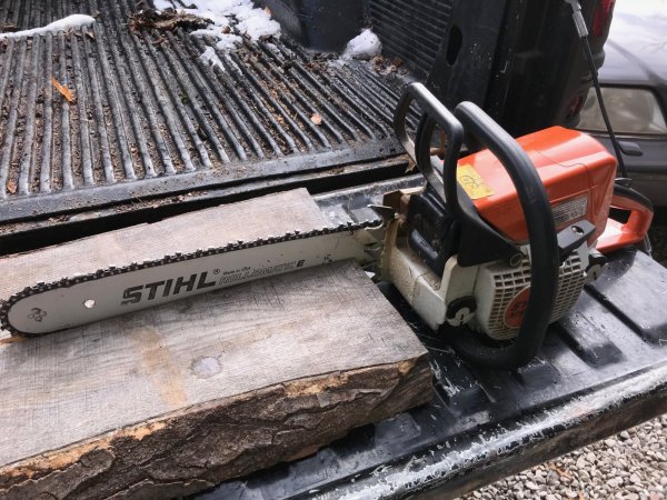

    MS391 with a second dog added, MUCH better...
    This pic is pre-MM. The muffler mod made a very nice improvement to this saw. Hearing protection is for sure required after that mod... Well worth it with the gains in cutting speed. Probably would be frowned on by close neighbors. Not a problem out here.
