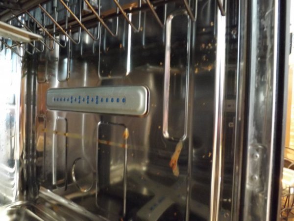

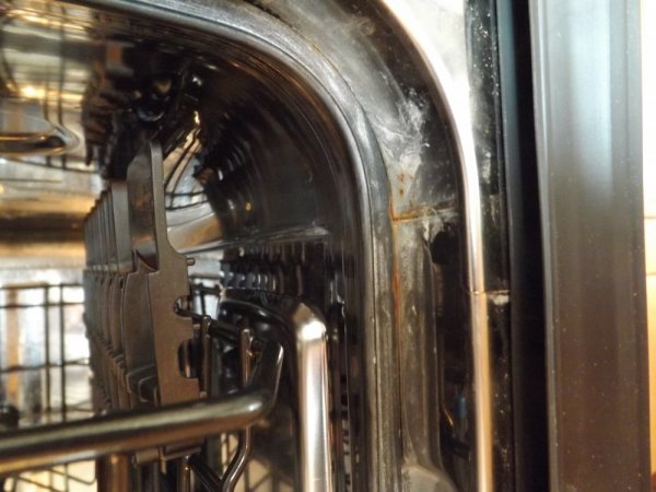

    Bad News: I did all my trouble shooting in dim light...............I waited till night when the lil one was asleep and the DIMMERS Jack Straw were low to avoid distraction. This is what I found yesterday in daylight after running my first load overnight.
    Are you kidding me? This was delivered in July and unboxed from factory 1.5 weeks ago. Humidity here is maximum 40% rarely, but usually in teens... Sent an email to the consumer relations gal that sent me the new part since there are no authorized techs nearby. :doh: Obviously from shipping overseas...wish me luck, the larger stains have already pitted the stainless....

    :picard:emailed these pics to GE. They sent citric acid cleaner. Running it now but I fear it will just open up the pits in the tub? WOW I regret buying this dishwasher.

    Point of stainless is it isn't supposed to rust like that- but that doesn't mean the frame work behind isn't- which indicates leakage. So hard to get anything now days that is even close to quality for any amount of money.
