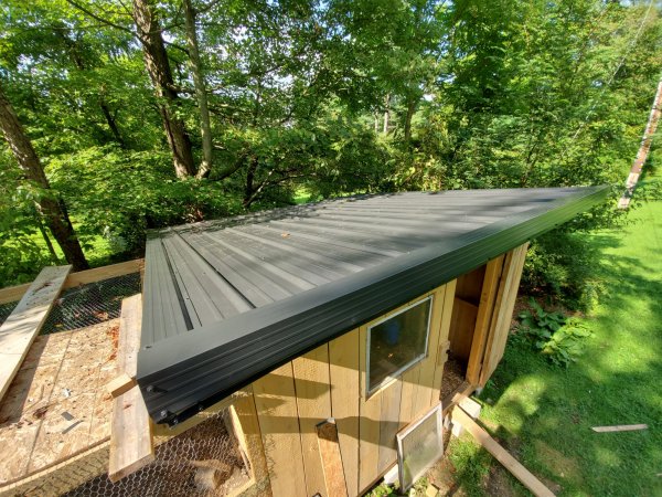

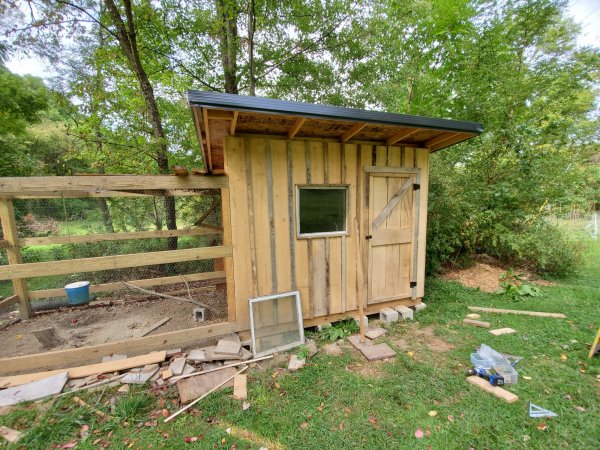

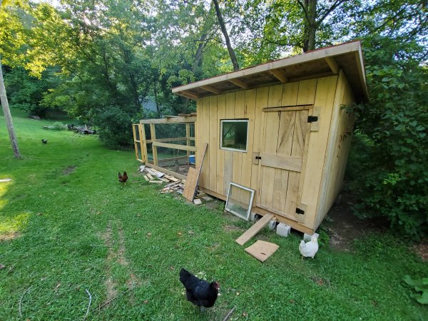

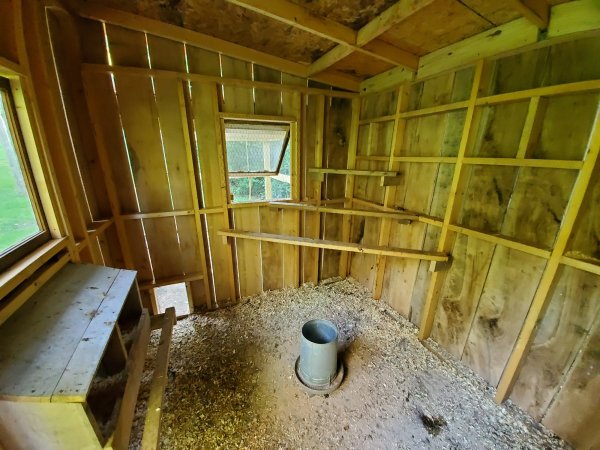

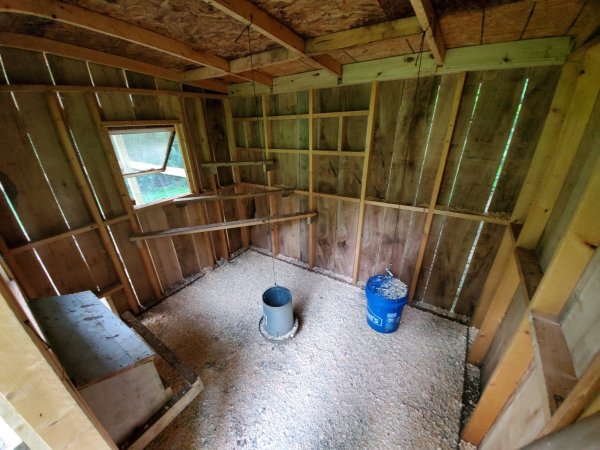

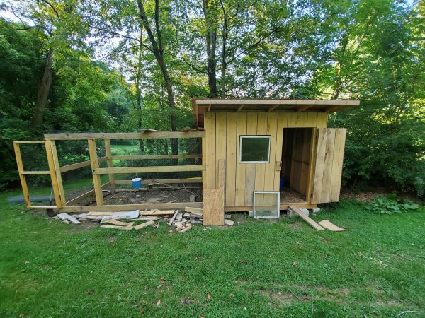

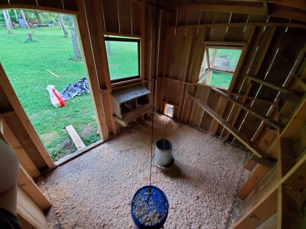

    I thought I might show a few of my projects from this summer. We moved to Ohio in fall of 2015. Down in N.C I built a really nice 6x8ft chicken coop with rough cut pine siding from my buddy Ericks sawmill. Well I finally got around to building a chicken coop here in Ohio.
    Armed with thoughts of what I would do better this go round I thought up my plans in my head and got to work. I decided board and batten siding this time and got a hold of Rusty who has a Woodmizer and lives a few miles down the road from me. I had him mill up enough board and battens to side the coop. He had a bunch of maple, so that's what I used.
    Meanwhile I got going on the framing. Plan was a 10ft d x12ft w coop that I could partition off inside to have a small storage area. Using 2x8's for the floor and framing it like you would a house. I got her framed up after work over 2 or 3 nights with the help of my neighbor Lou. And as soon as the rough cut was delivered I got to work siding. I left the battens off over the summer because it was warm and I didn't need them on yet and my wife wanted me to replace the deck. I ordered metal roofing from a place called Grabers in Glenford Ohio about 8 miles from me. Over all ive been lucky to have met and done business with a few Mennonites that live near me. Both Rusty and Grabers.
    Roof on, siding up, nesting boxes built and roosting bars in, I built a run on the side about 10x12ft but the birds free range nearly everyday. So that brings me pretty much up to date. I'll share a few photos and update as I go.

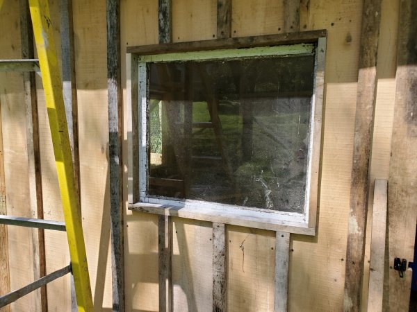

    Battens going on, window trimmed, door trimmed. And we went and picked some apples. It's been a great day.
