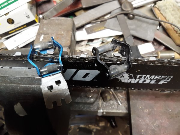

    You can’t cross them. 3/8 chain needs the blue one, .325 is silver.
    They simply won’t fix down on the wrong chain. Link spacing will prevent it.

    Also , be careful when selecting the 3/8ths roller guide . There is also a black one . The packaging isn’t real clear about what it’s for . It’s 3/8ths low profile .

  7. James Miller
    James Miller
    May 16, 2019
    562
    4,005
    Hanover PA
    20200309_085654.jpg I use the husky guides. Blue 3/8 black 3/8lp. Freehand in the woods then throw it in the vice every now and then and line everything back up. Wish I was a freehand filing master but it's just not there yet.
