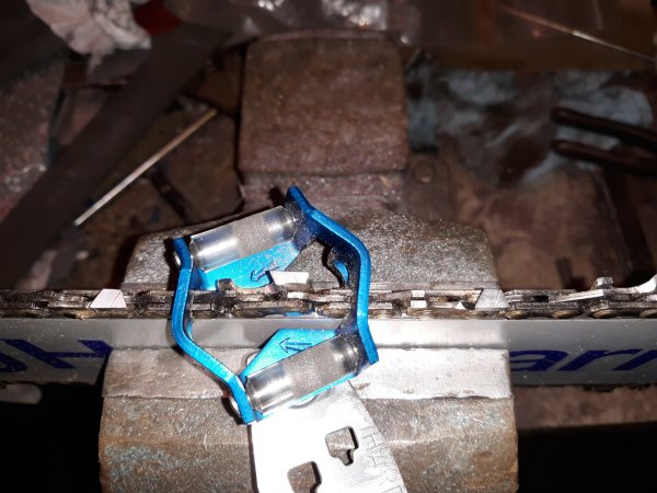

    20190601_210015.jpg The husky guides are cheap and work well.
    Makes it easy to keep a good all around firewood chain.

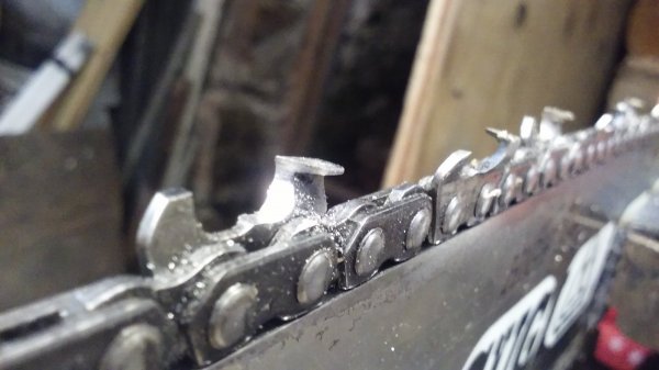

    I just realized the rest of my post was not posted. I used the Granberg File-n-Joint to sharpen that chain.
    Yea! It seems like once a chain gets hot it is harder to get the file to get a bite. I have gotten so I touch up my chain freehand after every tankful or two seems to help!

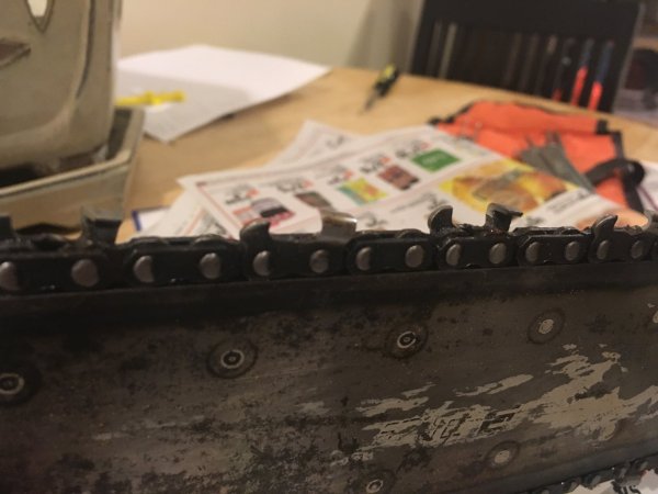

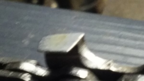

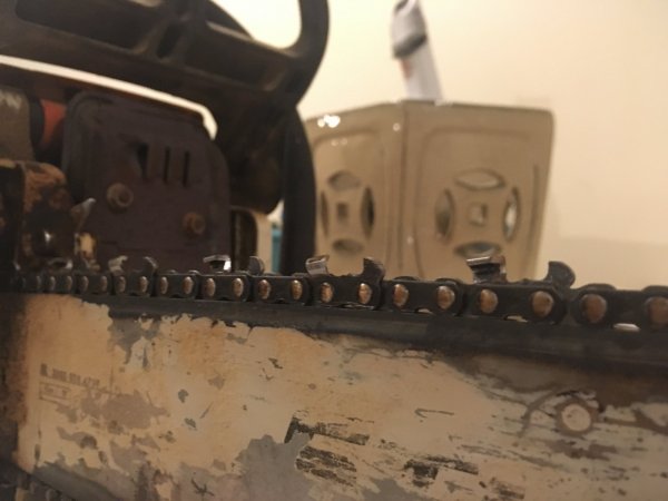

    Alright, I took another wail on the chain with the files. I didn’t see any mark to denote the end of the useful life of the cutters, but as mentioned, there is still plenty of meat on there. I noticed the cutters sharpened from the left side, were shorter than the ones sharpened from the right. Does that mean the previous owner of the saw/chain was left handed.
    Hopefully I didn’t take too much off the rakers. Instead of using the gauge from my cheapo set, I lay the file between two cutters and estimated three hairs width of depth.. I know, real precise. I’ll just be real careful when I cut into the silver maple tomorrow. If it is too grabby, i’ll just sharpen the cutters after a tank and see if it mellows out.

    Looks like it is still not getting down on the sides of the cutter enough, top plate still doesn't have much hook angle. As far as one side being longer that the other, if a chain is always hand sharpened, that usually happens, difference in filing pressure from one hand to the other. That will also. Make the chain cut crooked or curved. A grinder is the best way to even up the cutters. About every 3rd hand filing, I will true up with grinder.

    All things considered you would probably be well served buying a new chain to learn on. Sounds like that ones been through the gates of hell and back. Not saying it’s shot by any means but start with a known quantity. Once you know how the saw is supposed to cut you can gauge your sharpening skills.
    Take a good look at the bar while your at it. If it got hot enough to burn the lettering off it may be damaged also. Dull chains eat bars. Squareness is usually the first to go.
    Hard to say but it looks like your file is riding way too high on the tooth. A new chain will also allow you to set up your jig to the proper height and angle also. No filing, just set it up.

    The two photos were both after sharpening and the ‘sharpen from the right side’ had both more cutter left, and resulted in better hook when sharpening. I was tempted to keep working the left side until the hook was better, but since it was already shorter I stopped once the top edge looked ok.

    If you check out all the pics close, you should see (I think - some of them are bit hard to make out) that the sharp teeth others have posted are filed the whole tooth length, to the bottom. Whereas yours are only sharpened the top half or so. The file should fill the whole gullet, kinda sorta, that makes your hook. It might not with a new full height chain, but one that worn it should.
