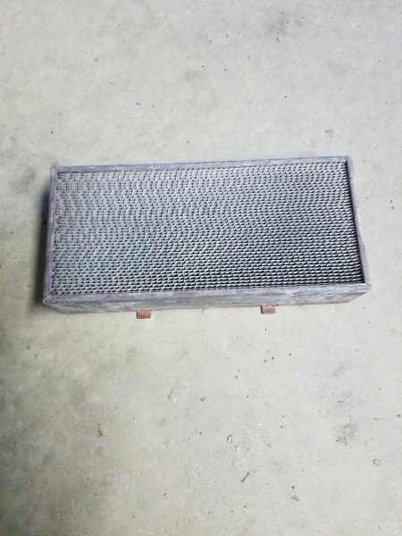

    Funny....its been warm a couple days here so I cleaned the chimney yesterday and cleaned the rest of the stove today,and changed the cat... .back in the fall I figured it had 11000 plus on it....gave it a vinegar bath and made it to today but still passing smoke at lower settings.its a blaze king/king and this is my 3rd or 4th cat....best stove I ever seen. 20200112_144322.jpg

    SKEETER, just curious why you are running a steelcat in your king ??
    I was gonna try one in mine, but everything I read over the last few years about guys going to the steelcat, said they’d go back to ceramic for the next one..

    I tried to save a cat with the vinegar boil and I did get a huge improvement but it was just temporary, another few months and I was back with a dead cat. Replacement is more cost effective than the cleaning procedure. The princess cat is cheaper at just 200$.
    it really is nice to get a new cat. They just kick butt.

    I’m one of those guys who has burned through one of each type and I saw no benefit to the steel. Potential drawback of clogging is greatly increased with steel and they cost a lot more for the same performance.
    I get ceramic cats now.

    Yes. HB, your the one on top of my mental list..

    yeah they do.....this aint my first rodeo

    It seems to depend on who you ask: I prefer SS cats. to ceramic for a few reasons. #1 is they pass more flue gas for the same size cat., SS cats have much thinner walls are are less likely to clog IME. #2 There is a lot more surface area, or more 'cells' if you prefer in the same size cat. when it is SS for the above reason (the cell walls are extremely thin). #3 SS cats. are not sensitive to thermal shock and therefore do not crack / crumble / break. #4 SS cats. do not spall, which is where the very edges of the cat. facing the incoming flue gasses crumble (sort of a variant on #3 but all the cats. I have ever seen have spalling if they are ceramic). #5 SS cats. are much quicker and easier to 'light off' and so do not need to soak over a hot fire to get the ceramic up to temp. before they actually work. This is a tremendous help on reloads- I find SS cats. do not require any open bypass time or increased draft when loading a stove with a bed of coals. Even if the combustor (cat.) stalls, it will re- light quickly when a ceramic cat under the same circumstances will tend to stay stalled.
    Again, all in my experience, and always comparing the two types of combustor in the same stove.
    I say in my experience because I actually monitor and record the temps. on the stove in four places: firebox top, directly above the combustor, the stove pipe (internal, in the middle of the pipe) just before the thimble and the stove top (outside). It makes the behavior of the stove easy to see when this data is graphed, and this is what I am basing my comments on.

    might be a Woodstock thing or just a stove design issue. With the bk stoves, the steel cats with their tiny cells have been clogging like crazy and the ceramic cats don’t significantly physically degrade unless you do something wrong like hit it, drop it, have leaky gaskets, ice on the fuel, or fail to use the bypass. In real life, the ability of the cat to start working at 400 instead of 500 is a non issue no matter how many thermometers you have.
    Neither steel nor ceramic is a bad choice. The upgrade cost for steel has proven to be a waste. In my experience anyway. I tried it.

    Where's the gasket?
