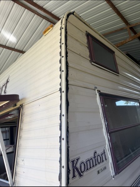

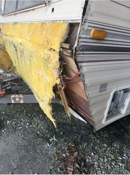

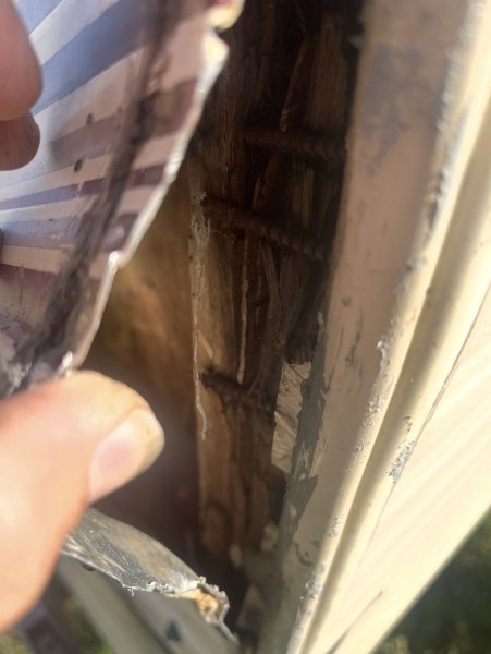

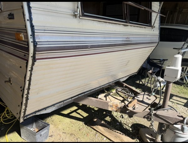

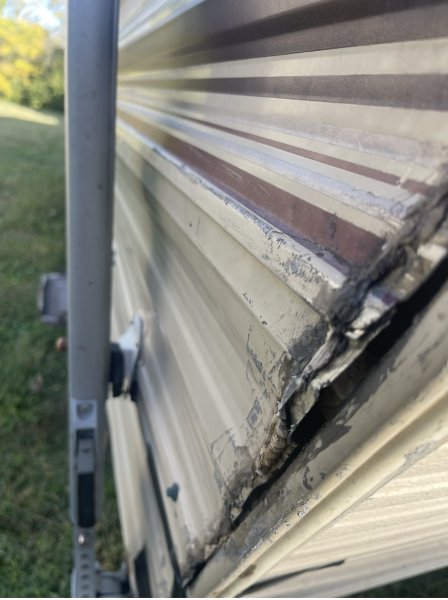

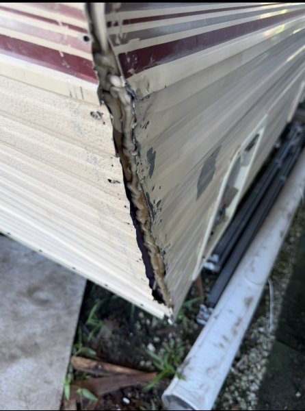

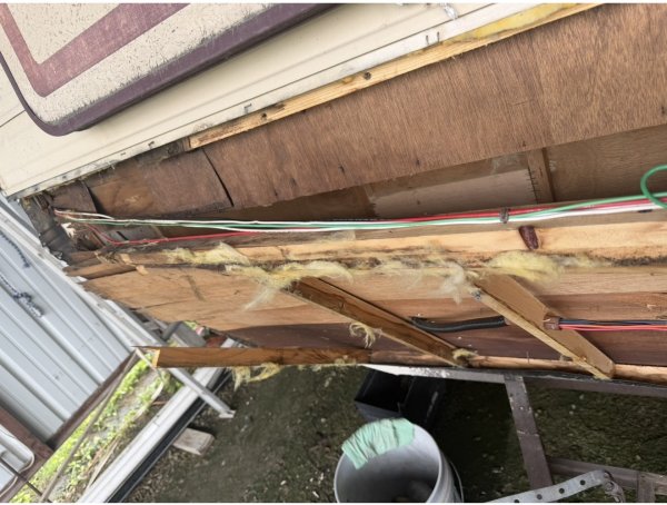

    When we were coming back from Walt’s GTG last fall …. Coming across I-70 noticed the side panel started to peel backwards… Gorilla tape to the rescue on the side of the road…

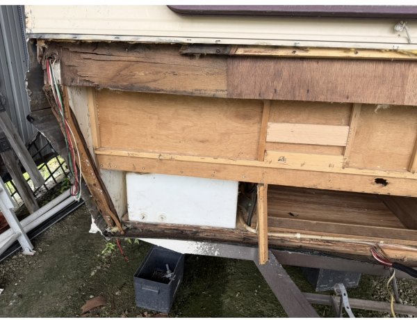

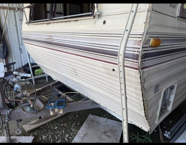

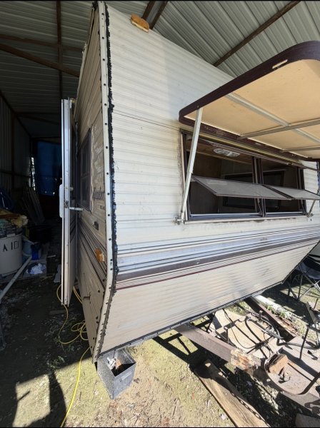

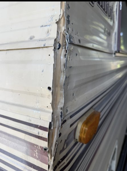

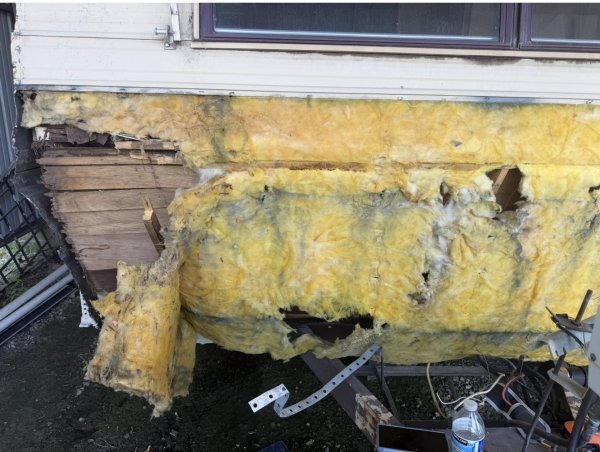

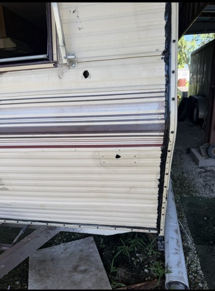

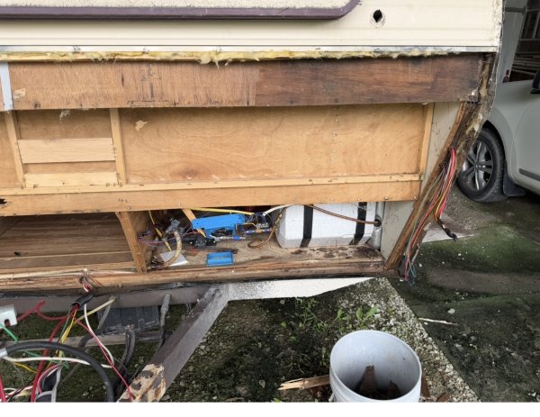

    So we removed the front skin….

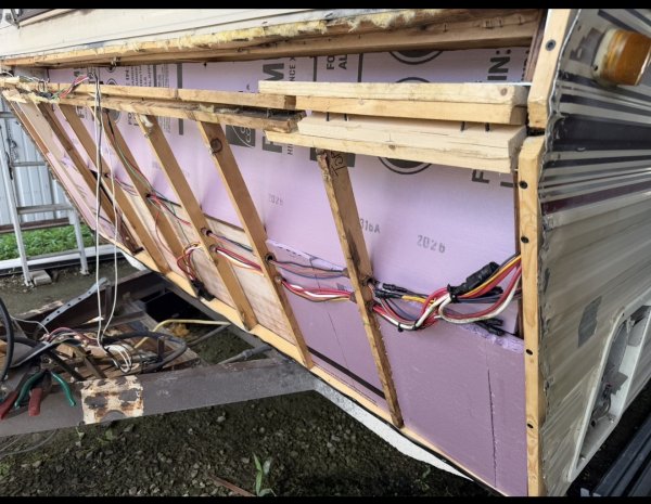

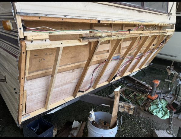

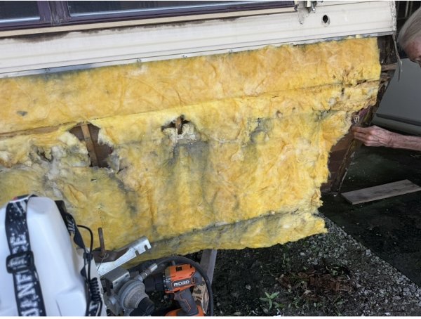

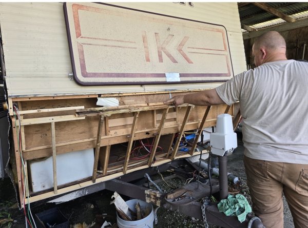

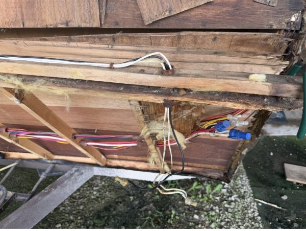

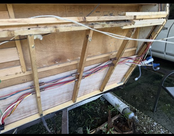

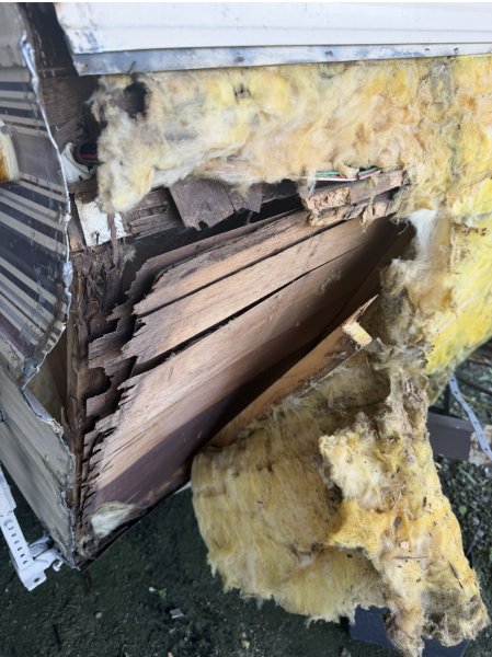

    Insulation out… and inside panels were so brittle…

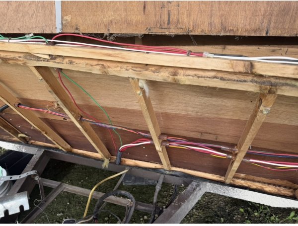

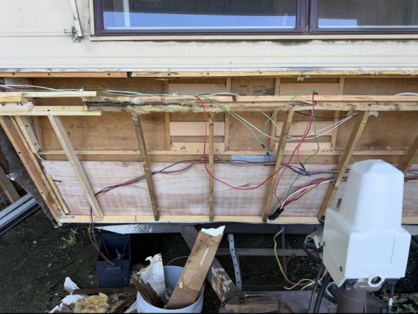

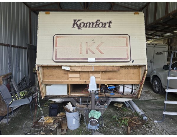

    Got the base clean… and started to plan on the rebuild…

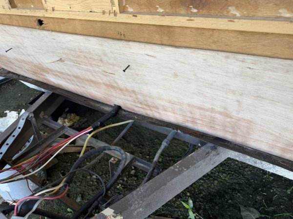

    The rebuild was using the base and adding good wood, gorillas construction adhesive, and long screws…

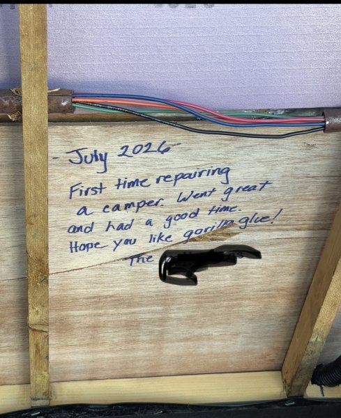

    Used some rigid insulation.. and cut it to form… and FordWoman99 decided to leave a note for the next person down the line if ever… :D

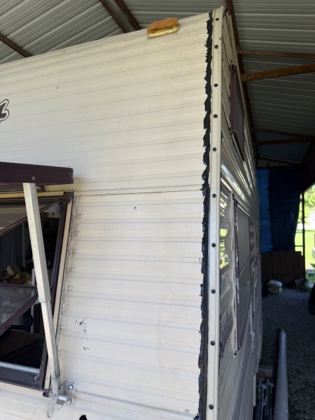

    Back together…. About 5 weekends a few long days in there… but it was a decent journey and learning experience….

    Just FYI, if you ever get into something like that again, and want an excellent caulk that has many color options...OSI Quad is top notch stuff!! Menards carries it, if you have any of those nearby... probably plenty of other places to get it too...

    Actually it was sealed in OSI Quad…. I just didn’t see the “other colors “ till I went back to another Home Depot that had them together… lol…. They came came highly recommended from several tech that I kinda of follow. Now I just need to figure out how to get a pretty bead… lol…

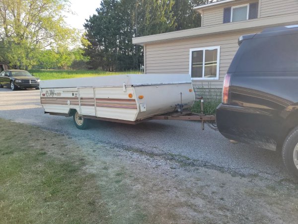

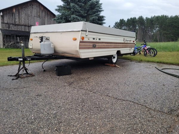

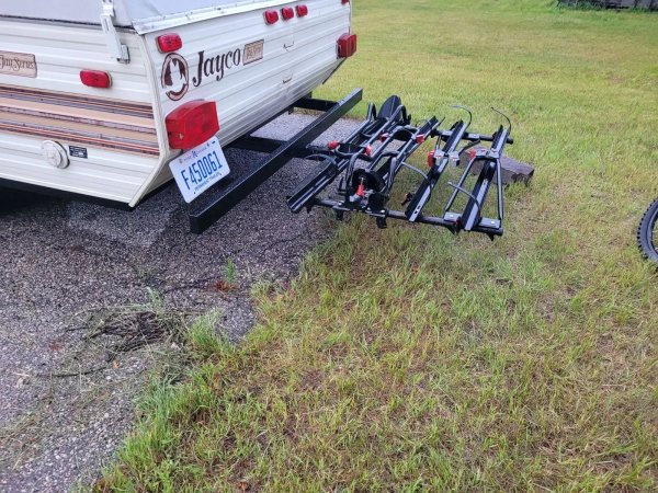

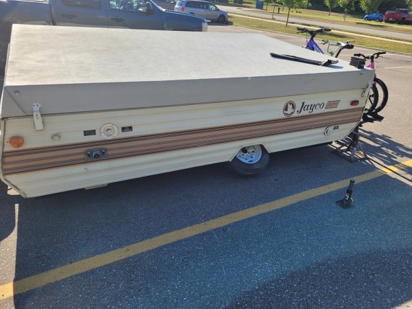

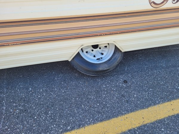

    We joined the camper crowd this year with a 1988 as well!
    Same thing, affordable & solid, recent new roof. Still ended up putting too much into it to get ready. (3) new tires, it still had the original 1988's on it!!, upgraded rear bumper for bike rack, painted frame, painted rims, new bearings, drop hitch, etc.
    And I still forgot to torque the wheel bolts before the first trip, D'oh!

    No real damage, tire actually survived and holds air, but has some deep sidewall scratches and slices from being dragged 300 yards to get off the main road.
    If I had remembered the extra wheel bolts (not lug nuts) in my truck before we left everything would have been easy, but I ended up repacking the bearings and swapping on a spare hub I had bought. 25 minutes later we were on our way.
