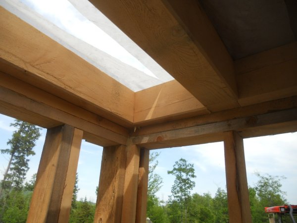

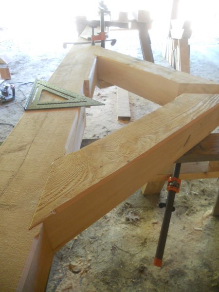

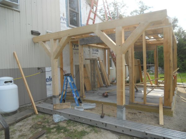

    Well it's been raining since I set those beams, and forgot to mention that it's now a 2 room addition. We're going with a 2nd floor. I was not happy with how I was going to have to build the roof, too low of a pitch to clear the window's above for a shed roof, and didn't want the snow falling off at the french door that will be in the front. I'll be jogging the 2nd floor 4 1/2 feet forward so that the existing roof will match up and other reasons that simplify the roof for snow considerations. I built 2 of the 2nd floor walls on the ground between rain showers and will lift them into place. Played around with a faux post & beam looking beam that will support the 2nd floor yesterday. DSCN8787.JPG DSCN8788.JPG
    I dug some 4' holes for precast cement piers for the wood posts to sit on. Nasty digging even with a hydraulic post hole digger with a 30" auger, too many big rocks.

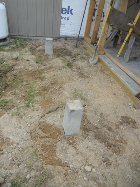

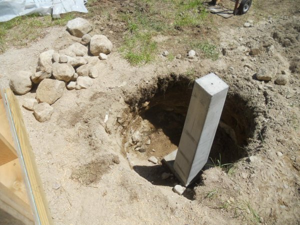

    Piers are in! Those are some of the larger rocks that came out of that hole:eek: DSCN8793.JPG DSCN8798.JPG

    Alright then.........
    These are some medium ones. Couldn't find the pics of the big ones:D

    That's more like it.
    At my previous house my ex was digging holes to put in chain link fencing for a dog pen. Had a hole at big as for that shown with the column and couldn't find the end of the rock. Ended up moving the gate to a different location instead. Same thing happened when trying to place posts for clothes line. The entire location got moved because of the rocks in the way.

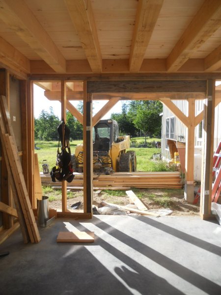

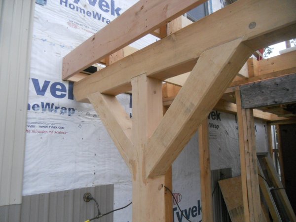

    Set that beam & post deal today, should help "soften" the not very fancy metal exterior, there's a long story behind that. :whistle:
    That big wood 'theme' will flow right into that first floor room's ceiling. A double french door go's in that opening to the room.

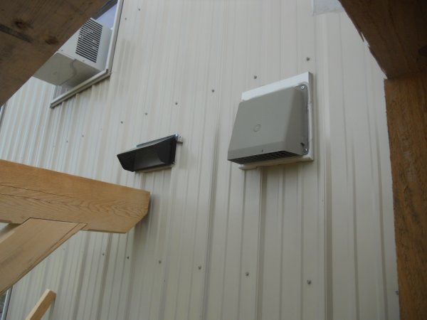

    I'm not looking forward to extending these! (kit. stove top fan & bath fan) I hope to just 90* them onto the front face but they are
    in the floor joist and will require a pretty big hole in them. That portion of the floor will be conventional 2x10 framing and get stuffed with foam being it's exposed to the exterior w/living space above it.

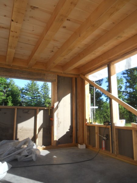

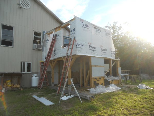

    Slow but somewhat steady. Got the 1x10 pine ceiling (above the floor timbers) down and the 2x6 t&g floor for the 2nd floor down. The 3 walls for the 2nd floor are built. I'm putting the foam in them while their on the ground, a 2.5" layer between the studs and a 1.5" layer outside of the studs in between the purlins for the metal siding attachment, Tyvek also. Much easier than doing it all off scaffolding. The walls should be about a R- 39 with 4" of foam and 3 1/2" of fg insulation. Hope to set some of the walls tomorrow.

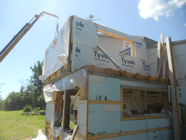

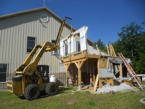

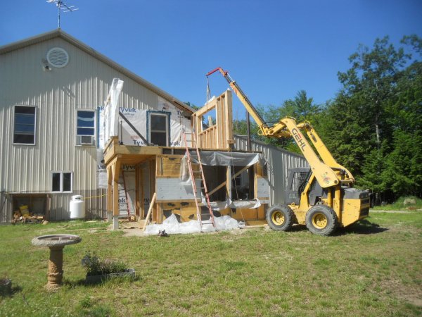

    Set the 2nd floor walls today and tied in some of the outer layer of insulation & tyvek buttoned up.
