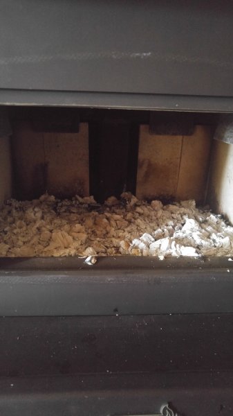

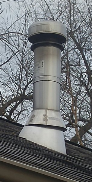

    Lots of running around yesterday. Didn't get a fire going till 3:30. While I was outside before it got dark I always look at my chimney to make sure it's not smoking. It wasn't. But I woke up to this. Awful dirty I think. Please tell me what you think.
    Inside the stove.

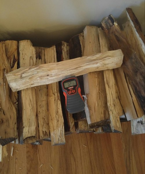

    This is the wood I'm burning. 1120160918-1.jpg 1120160906.jpg 1120160813-1.jpg Sorry I messed up the pictures. But you guys get the idea.

    I doubt it is anything to worry about. How old in the chimney? You might get up top and check the cap to be sure.

    I don't see anything there that I'd worry about. Your firebricks are quite clean, and your ash looks burnt down to nothing, save for the black chunk I see. That was probably the culprit (my guess) once the other wood burnt off. I've had the same thing happen often in shoulder season.
    Are you sure it didn't happen at start up when the stack wasn't warm yet? I've seen my smoke come out, roll down a bit, and then wisp away on a cold start.

    The cap will get the dirtiest being exposed to the cold temps. Check it out from the ground with some binoculars first to see what kind of buildup you may have. Hard to tell from the pictures. Caps as well as a foot down from the top will get slightly stained from burning and will wash up after the burn season has ended. Keep an eye on things, occasionally checking for buildup in the pipe.

    Thor, remember it is also quite common for the chimneys to turn sort of brownish at the top. Nothing to worry about but always be aware of the top of the chimney getting some creosote and also keeping the cap clean.

    Can't see inside the cap, if you are really worried about it check inside the cap and make sure whatever screen may be there isn't plugged. But looks pretty normal to me. And you say you saw it was not smoking, so sounds like no big deal to me. Grab a beer, sit down by the fire, and chill. All stoves will smoke during startup, and this will eventually discolor the top, and doesn't self clean with a good hot fire like some of the internal sooting might.
    :cheers: :fire:

    Looks like a good burn to me. Quite normal for some discoloration at the cap, I don't see any creosote running down the flue so I'd say you're fine.....
    Your wood is definitely seasoned!!

    As others have said it looks like it's not a problem but if it bothers you always best for piece of mind to get a close up look if you can. My guess is, if you have not seen this before it may be that you had just a little different wind pattern and it made the exhaust drop when it exited.

    If that's all you got after 3 years of burning,,, :salute: !
    Looks very clean to me. You're bound to have a smoky fire now and then (especially if you're trying to teach the wife to run the stove!! ;))
    Now if you had black drips running down the side? That would be bad. That's the bad sort of creosote, and if you see it on the outside, there's probably 100x as much built up on the inside.
