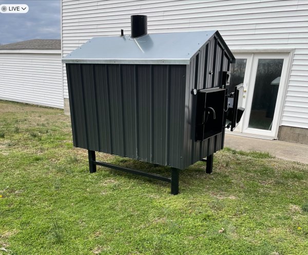

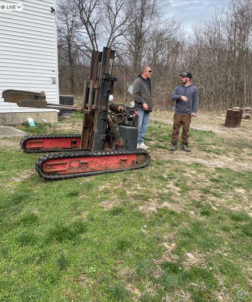

  16. Sourwood
    Sourwood
    Jan 4, 2018
    1,734
    13,094
    Popcorn, IN
    situation resolved at much less than replacing with a Central Boiler. I think this brand is EZ. Formerly Richmond, I think. Th3 firebox is round rather than squared.
    Men installing say Central units generally last about 8 years. They have one of these 15 years of service. Moved the old unit off the pad and placed the new unit in.
    Neighbor plans to hook up his existing plumbing this weekend.
    My boiler is about a year newer. Told the guys I hope I don’t see them again too soon.

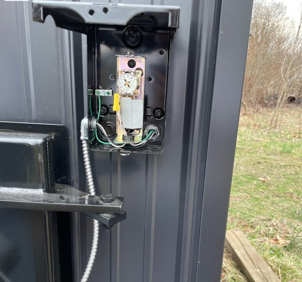

  20. amateur cutter
    5,826
    46,607
    Yes, same unit as pictured. Very simple and relatively bullet proof design. Only failure I've had was a couple damper solenoids. One wore out and I got a defect on Amazon. Otherwise no issues. Not the most efficient unit, but I wanted minimal parts and electronics. These meet that criteria for certain. Still running the original pump and door gasket after 3.5 seasons. No leaks or other issues. Only thing I would re design is the draft door should be full width. They don't get a complete burn on the sides of the firebox. Load a pyramid shape in the center to mitigate this.
