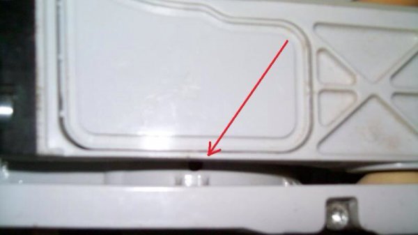

    Thanks.... but there is no "hole" ? There is what looks like to be a small 1" x 1.5" plastic panel that does not look like it comes out. It looks like a pre-stamped panel that would be cut out "if" the saw had this option or something. Maybe the "panel" comes off...?? I didn't want to break it pulling up on it with a small screwdriver, but it looked like it was permanent. This is on the bottom of the saw, towards the front. No "hole" anywhere around where the marking is. ??
    I should add/remind, this is a 362C-M. Possibly the Mtronic does not have adjustable oiler?

    Plenty! I know Stihls pretty good. Other guys here put me to shame on the vintage stuff and other brands.

    oooooooohhhh krykeeeeee!!!! Thanks man. Didn't see that, I was focusing on the "panel" looking thing the imprint is on. The manul could be a bit better and point it out, all it says is "If there is a chain oiler adjustment on your model saw, it is on the bottom of the saw, please refer to the marking notication" or something like that.
    Sorry to hijack!
