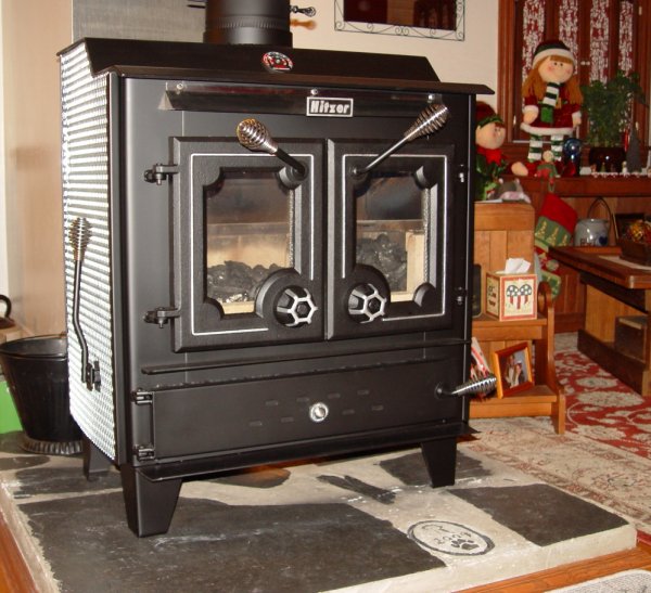

    Let me try this from my phone for the first time...
    This not my stove but one that a fellow forum member owned on another forum. Hope he doesn’t mind me borrowing his photo for illustration.
    Don’t have pictures of my stove yet but this will give you an idea. Mine is trimmed in gold.

    The silver sides on the above stove are not factory but something the owner put on as a form of protection for the kids...it’s expanded metal. Mine just has normal sides and is a blower model as well. I believe the pictures above is strictly a radiant stove.
    That should give you a good idea of what I bought. I’ll try and get some pics posted of my stove in a few days.

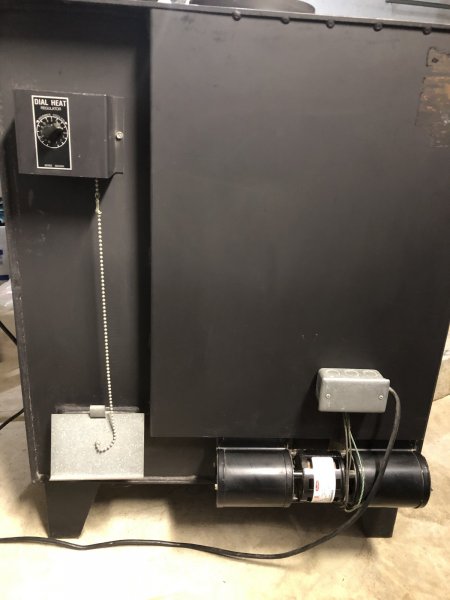

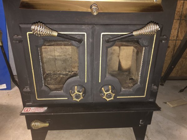

    0D5CAD94-6DA9-4914-ABC6-507CE3CFDC16.jpeg EC48FB9A-CCD5-4EE2-AB0C-7E1EADE36BF3.jpeg BC2C0AA6-B832-4072-8AAD-34ACFA274D0C.jpeg 64398FF0-D432-496E-9A2E-B16BC693A9B7.jpeg
    Here are some pics of my barely used coal wood stove.
    Phone got the pictures before the quote...haven’t figured out how to fix it or cut, copy, and paste yet on this iPhone.

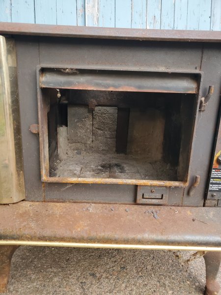

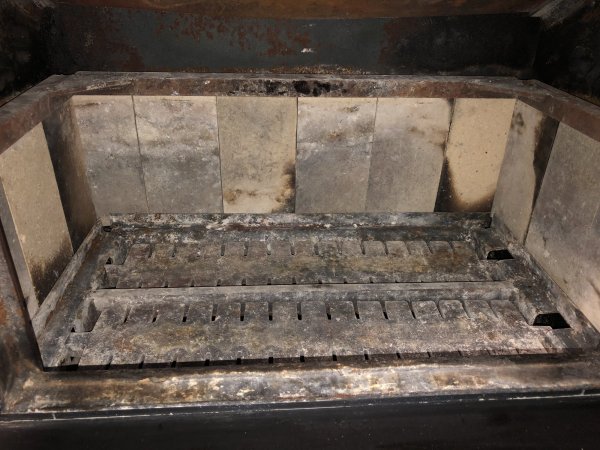

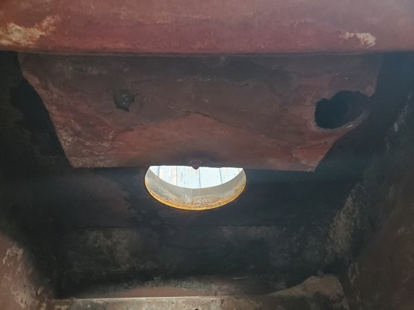

    So this is the older PE Super 27 in question. It's a bit of a commitment to get this up and running, the least of which is a completely new baffle assembly, priced at about $400 CDN. 20190818_191354.jpg 20190818_191359.jpg 20190818_191418.jpg
    I am thinking I can probably get a smaller new Drolet stove for around $800, whew lots to consider
