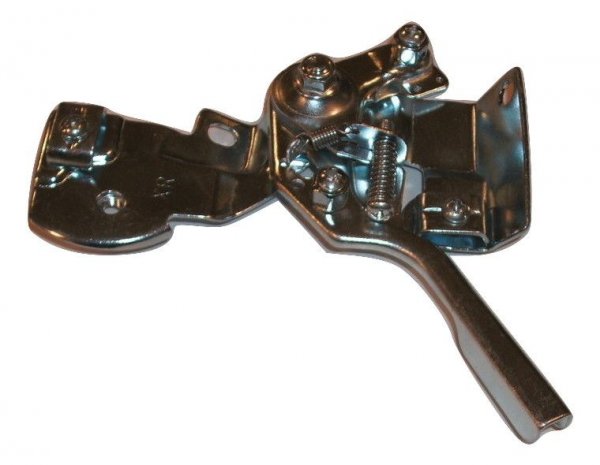

    So now I'm confused...you have one like the top pic (I thought) or the bottom pic there?
    For the $10 these things cost on ebay no way I'm wasting my time scrounging around a junk yard on the off chance that I actually find one...

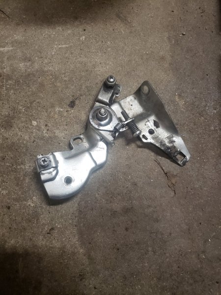

  8. LinkedXJ
    LinkedXJ
    Oct 12, 2015
    1,448
    7,205
    Indiana
    This is what i have

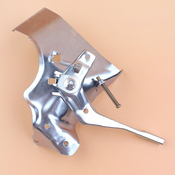

  9. LinkedXJ
    LinkedXJ
    Oct 12, 2015
    1,448
    7,205
    Indiana
    Similar to this
    Not exactly the same, but very similar. Im sure it'll work.
  10. brenndatomu
    25,311
    164,778
    That's what I thought...so what was the other pic from?
  11. LinkedXJ
    LinkedXJ
    Oct 12, 2015
    1,448
    7,205
    Indiana
    That is the bracket for a Honda GX390, someone here recommended that being the replacement.
    Looks so much alike, doesnt it? (lol)
