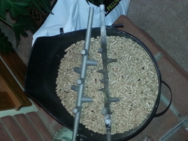

  9. eatonpcat
    10,268
    58,386
    Got the new auger yesterday!!
    The old and the new.
    Not sure why images load sideways from my phone??
  10. jtakeman
    12,307
    55,483
    Got to be the operator! :p
    I'll be ordering mine in a few weeks. I'll post a pic of the old auger next cleaning. Not sure I'm gonna like the cast version. Might see if that ebay fella will make me on I can fool with. $124 bucks is too much IMHO. Dam Enviro parts will break ya! :mad:

    That's a factory one, or the guy on eBay? Cast, mild steel, or SS?
  12. jtakeman
    12,307
    55,483
    Enviro said it was an Investment cast SS.
    Personally I was fond of the weldment. But I guess all the welding was too costly for them, So they came up with this cast version instead.

    Supposedly OEM SS, We will see how it lasts.
  15. jtakeman
    12,307
    55,483
    Same as your original. Pretty sure all stoves after late 2008-early 2009, had the new cast SS version.
    From what I have seen the weldment version seems to have lasted longer. Weldment has approximately a 5 year life span(going by mine and a few fello Omega owners) and the cast SS is around 3 to 4 from what I have seen. Of coarse this depends on heat level and pellet quality. Pellets with higher sodium content and stoves run up on high heat level seem to be eating them faster.
    Now comparing price the weldment was approximately $30 more expensive than the cast version. If that matters?
