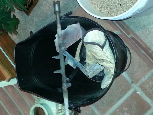

  17. eatonpcat
    10,268
    58,386
    Here's a bad picture of the auger...you can see it looks like the middle tines have been whittled to a point! New auger has been ordered. Thanks for your help!
  18. imacman
    imacman
    Oct 23, 2013
    6,630
    27,517
    Denver, NC
    Just curious....how old is that stove (auger)?
  19. eatonpcat
    10,268
    58,386
    Only 3 years old...Somewhere around 15 ton of pellets. Seems like it cooked too fast??
  20. imacman
    imacman
    Oct 23, 2013
    6,630
    27,517
    Denver, NC
    I've gone through at least that many pellets, and probaly more, plus mine was a refurb and i know the stirrer wasn't replaced. Mine looked like this at the beginning of this winter:
