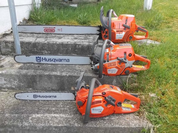

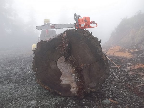

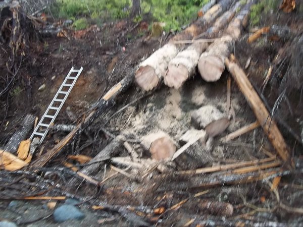

  7. campinspecter
    campinspecter
    1,684
    12,236
    Back saw 390XP 36" bar.
    Middle 562XP 28"bar.
    I use the 390 when I encounter big wood!
    The 562 had no problem with these logs. ( look at the ladder for a comparison for the diameter and size!)
