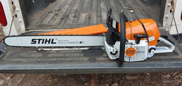

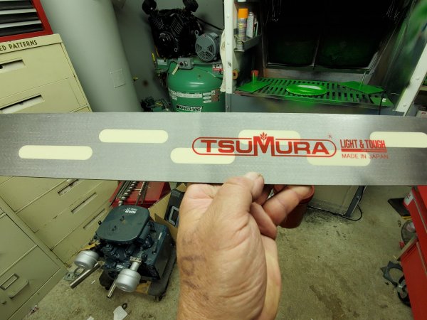

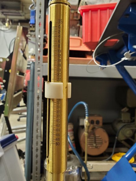

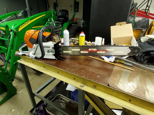

    The bar's tracking number said Monday but it arrived today !! 20200620_142428.jpg

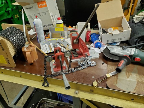

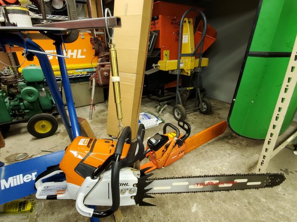

    I was spinning about 20 minutes later. 20200620_191042.jpg balance is awesome !! It's hanging from the handle. 20200620_191107.jpg
    Fully fueled and oiled.
    Thanks guys for the help, it is a fun saw now.

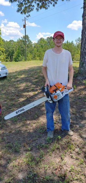

    Since I already had the 28" Tsumura bar, I asked the dealer if we could swap bars on the 461. Got 32" B/C no charge. My son said he wished he was big enough to run that saw...lol... 0620201349_HDR.jpg

    He looks big enough to me.
  7. T.Jeff Veal
    29,848
    191,841
    He probably is, he said the saw looks big compared to him. He might weigh 120# soaking wet...
  8. Eric VW
    24,575
    141,809
    Looks like he needs a left hand version.....
    :whistle:
    :D
  9. T.Jeff Veal
    29,848
    191,841
    He was just holding it that way to show decal.

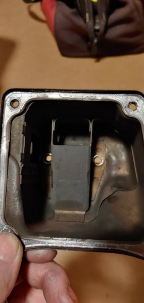

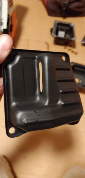

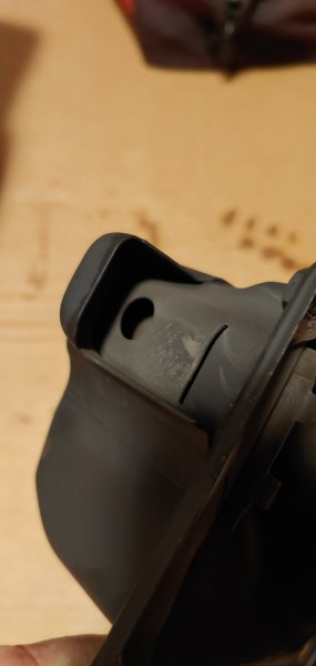

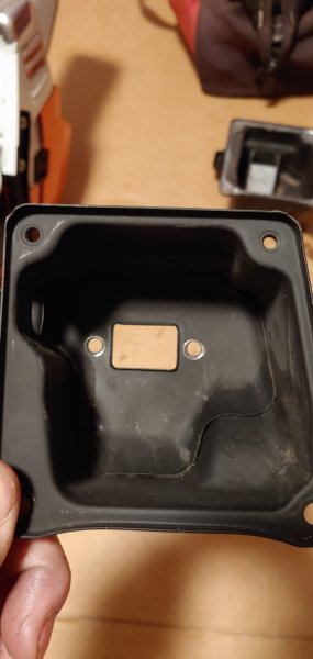

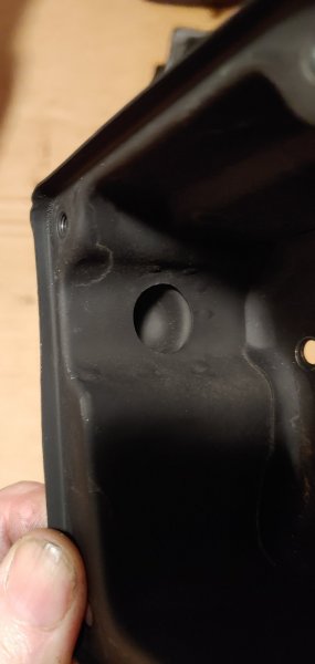

    Screwloose did you do a muffler mod to your saw yet? I found a dual port muffler for the 461 on eBay(customchainsawparts) I think for $20. It is opened up and sounds good.
    Factory muffler 0622202025_HDR.jpg 0622202026.jpg New muffler 0622202026b.jpg 0622202026c.jpg 0622202026d.jpg

    That's the place I bought the skidplate from. I saw that they offer a machined aluminum dual for the 661 with screw out screens. I dunno as I added 1 hole to mine and it really barks now. Mainly trying to get rid of heat as it's the hottest saw I've ever run. Someday I expect the brake handle will melt.

    Summer/winter shutter in winter mode?

    Looks good Screwloose Now you’ll see what all the fuss is about. :thumbs:

    No it's in the summer spot. I think it's just me not used to a saw running so close to lean. Inside of the muffler was clean with heat colors, purple and straw. I did my initial testing on the 50:1 motomix fill from the dealer but I since have dumped it and filled it with my normal 40:1 E free/red armor mix. Only a couple of test cuts on that though.

    Good move IMO! :yes:
