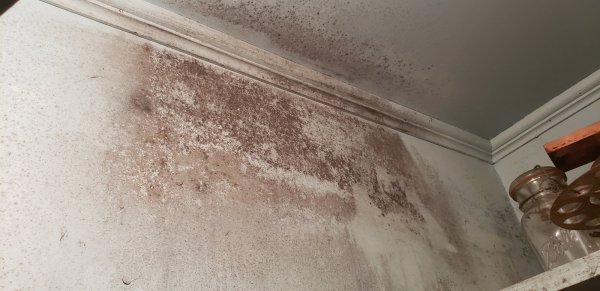

    This house is 61 years old. Brick home built on a slab. Central heat and a/c. The house smells musty. Clothes removed from the home... I smell them elsewhere and they smell like the house... musty. I have found mold on the wall in the pantry and in a closet. Before I did anything, I bought a mold test kit. It didn't find anything terrible. Mild mold infection, really no big deal from the readings, and what is bizarre is I tested the pantry, which is a small enclosed pantry and it had mold on the wall! I figured it would be off the chart bad. After testing, I treated it with chlorox and it wiped it out but it slowly came back. This was couple of years ago. I sent the mold test off and got a report back. There was no warning of black mold or "Hey, sir, you have a problem; it was minor readings even in the pantry!' I will try to find that report and review again.
    I am going to remove the sheetrock from the pantry where the mold is. And in a closet that is rarely opened. Not much there, just a little. For brutally hot summers, the house also had radiant barrier (aluminum foil) installed in the attic decades ago. It was just rolled on top of the existing batt insulation loosely. After I feared mold growth, I feared the attic being a moisture trap and even though the aluminum foil radiant barrier had small holes poked it in during manufacture, I just removed it all. Back to the original insulation up there.

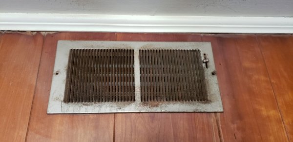

    The mold that is in the pantry is a direct imprint (see photo) behind an a/c vent that goes into the den where I sit all the time. So, I am worried that the central heat/air is moldy in the system and ducts. Or, at least, dust is being piped into the house all the time. I don't understand why mold would be growing behind that vent. It's obviously some physics going on there... moist due to the venturi effect or something (lol... I have no idea). Any idea what this means?

    Pic 1 is an a/c vent into the den
    Pic 2 is area is pantry behind the vent

    Getting rid of mold/mildew on porous surfaces is tough to impossible. Clorox will kill on-the-surface and maybe part way into the surface, but not get all the little roots, so mold eventually comes back. Tear out an replace any sheet rock that is moldy and for a distance beyond - those roots will be in areas that aren't showing surface mold yet. You could also try a special paint like Kilz, but even that is only guaranteed for a short time.
    Makes sense that mold would grow in a cabinet or in any area that doesn't get good air circulation. You can get little microclimates of air with more moisture, and I would think an A/C duct could cause condensation in a still area (I'm not an expert, and don't even have any ducts in my house, so I'm just hypothesizing there).
    The ductwork, as a solid surface, should be easier to clean - easier as in killing the stuff not necessarily reaching it. It may be worth your time talking to a remediation company about cleaning the ducts out instead of trying to do it yourself or replacing. Once cleaned, using the right type of filter, replacing the filter when needed, and using a dehumidifier (if your A/C unit doesn't incorporate one in the system) should keep it at bay.

    As for the mold i'd just take the wall down and deal with the main problem.

    Did you go up in attic and have a look at where the insulation stops at the soffits? When we moved here years ago i found the original owners insulated over them and had very little air circulation. Used a hard rake and pulled it all back 6in.:whistle:

    Did you say? Are you running a dehumidifier ? Maybe a larger model, or a couple of them. Can you keep the pantry door open if it has one to allow some air flow? Do you have gutter's routing rain water away from the house? I wonder if setting your furnace fan to run every now and then on a timer would help dry things a bit. Random thought's! Old place's are a bugger!

    Just a few thoughts. Do you have weep holes at the bottom of your brick walls at the foundation/slab? Maybe check and see if they are open. I've seen them caulked over, washed in with dirt and mulch.
    Maybe pick up a small digital thermostat that also measures humidity. You may get a better handle on where the humidity is worse.
    When reading this, I was thinking is there a gap at the duct work where it goes through the wall? Could be condensing on the wall where cold conditioned air goes through the duct and warm air from inside the wall meets up.
