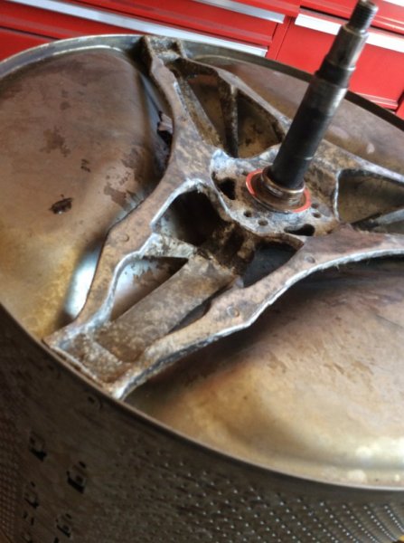

    Digging up an old thread to bitch about kenmore washing machines...
    This is the second time the same part failed. The first time the 'spider' support bracket disintegrated into a million little pieces. Apparently the updated part is made out upgraded chinesium. This time shaft separated from the bracket... I figured no problem I'll order a new spider bracket and be back in business for $50 for another 3 -4 years. Except the part is NLA with no known replacement. They will sell me the whole tub assembly for ~$500; :(
    Time to try a half azz fix.
    The bearings and shaft seal are also NLA. I ordered generic bearings as the originals aren't in great shape. One of the originals had an oem specific part #. Hopefully it didn't have some special weight rating.

    It really bugs me that parts are NLA for a 7 year old washer...
    Not really wanting to spend the money on a new one I expoxied the shaft back in place. I started to use a wire wheel on the chinesium but it was taking to much material off. So I cleaned it the best I could with sand paper and will hope it holds when I drive the bearings back on tomorrow.
    It was originally put together with some sort of expoy so it should last for a little longer... But it's not a great design the shaft and bearings support all the weight of the clothes and water in the tub. And take quite a beating on spin cycle.

    Funny thing is I had picked up a 5-6 year old kenmore he3t washer on cl for free this summer. The owner said that it started leaking a little from the front door seal. The sears repairman said it wasn't worth paying to have fixed.
    The tub spun nice and smoothly so I put it in my basement. I Hooked it up and started using it when my upstairs one broke... It worked great for 10 days but it broke something similar and now barely spins. I have to run it on low speed and delicate settings so it doesn't screech too badly.
