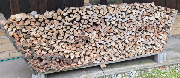

    Here's a picture of what I think you're talking about.

    I have several racks similar to the one Jeff posted above. They work fine.
    I do try to have the end 2x4's be as vertical/plumb as possible. I fill in around the 2x4's with crushed stone i have around.

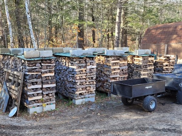

    There are many ways of stacking wood, even without a wood shed. I have dealt with firewood and heating with stove for over 75 years now. So how do I handle the wood? Here are just 2 pictures to give you an idea:
    I simply stack wood on small logs that I have in our woods. At present I have several pines that have died and I cut these into 9 foot lengths. Simply lay the logs on the ground and start stacking. By cribbing the ends I don't need anything else to keep the stack good.
    I stack wood where it will get good air movement (sounds like that is not a problem for you) and this will dry the wood nicely. Also it helps to give the wood sunlight. By the way, we normally leave our wood in the stack 3 years or more. You will no doubt be hearing more about the 3 year plan and this is a good thing.

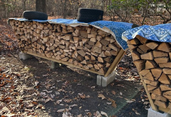

    Yep, I have many like this. I usually put another cinder in the middle and if am using 2x4's I turn them up for more support. I've used 2x4's and landscaping timber across the bottom as well. Either or works great and they are stupid simple to slap together, no fussing with cribbing or pallets which in my area are prone to termites and get chewed up in a few months unless they are plastic. I had an abundant of cinder blocks just laying around the property.
    I think one rack is a face cord, 3 = 1 cord of wood. I usually stack two together (of course this pic only shows 1, but there are two stacked together next to it partially shown)
