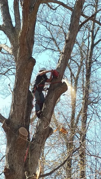

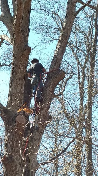

    This is the group that came to the 2019 GTG in Chesaning MI at Backwoods Savage place. About 65-70 great folks were there by Saturday. And we played with saws, wood splitters, cut firewood for a couple folks and ate some great food. 100_0593.JPG
    Here is Scotty Overkill showing us climbing skills. He took out several big limbs from this huge white oak, making it easier to drop. IMG_20190504_163426542.jpg IMG_20190504_163519794.jpg
    And then walt went to work on the trunk, using a Tree Monkey built (I think) MS661 with 36" bar. That tree was about 42-44" dia. IMG_20190504_164959188.jpg
